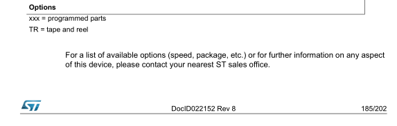

This time when ordering a new batch of '405 processors, they (farnell) are offering the STM32F405RGT6V and the 'V' here was new to me. So I looked things up in the datasheet. There it says something like: 'xxx' packaging options like TR for tape and reel.

There it says something like: ''***'' packaging options like TR for tape and reel.
No, it says ''programmed parts''.

Yes, ok, the point is, it says 'xxx = programmed part, TR= tape and reel' but nothing about 'V'.

Yeah. Basically, the datasheet is telling me it is a programmed part for a specific customer. But that makes me wonder:
