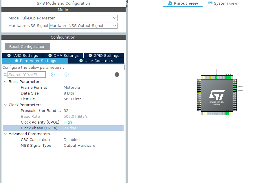

Prescale to 32 to have a baud rate of 500Kbit/s (Maximum frequecny at 1Mhz) / CPOL to High /Clock Phase: 2 Edge.

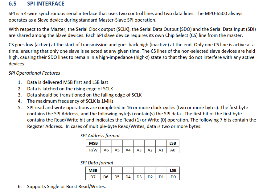

Here are the characteristics of the MPU6500 :

It was just the NSS signal. If i try to do with a "HAL_GPIO_WritePin" to drive NSS signal it's works.
Did you know why?
2024-08-23 6:18 AM - edited 2024-08-23 6:18 AM

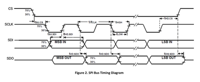

You're not doing anything with CS. Bring CS low before the start of the transaction and high afterwards. Initialize it and control it as a GPIO output pin.
I would also guess the data registers are meant to be read in one single transaction. If you read 6 bytes from 0x3B, you will get addressed 0x3B, 0x3C, 0x3D, etc...
2024-08-27 1:58 AM
Thanks.
What is the point of putting NSS on an NSS physical pin in the CubeMX configuration?
Unless I'm mistaken, that's already the case, isn't it? In this example I read the registers in a single transaction, right?
2024-08-27 5:54 AM
In master mode SPI on the STM32F4, the NSS pin output is low, always. It does not toggle at the start and end of transactions.
