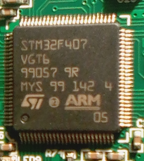

context is, that I have some STM32F407 marked with "4" as revision, and returning 0x1007 as DBGMCU_IDCODE.REV_ID (example UID=200047000F50345339323520). Even if these were bought at a 3rd tier dealer, I don't think anybody would go and counterfeight revisions, so it's easier for me to believe that the table in RM0090 is simply wrong. The fact that in RM0090 Rev.6 the table gave different values (although there was no Rev.4 at that point) just increases this notion
I tried to locate some historical 'F407 specimens, but all I was able to find were Rev.2 which return 0x1007 as expected; one friend of mine reported Rev.A on a Disco but that returns garbage as per erratum, and I have an STM32F457 (sic!) on the EVAL, which is ES... so no luck finding other Rev.4 to compare.

I did a test with STM32F407G-DISC1 revision Y board and the REV_ID=0x100F as already described in the RM0090.
Can you please share the chip photo of the STM32F407 revision 4, that return REV_ID equal to 0x1007.

0693W00000VOWJXQA5.pngThanks for your support.
Jan
