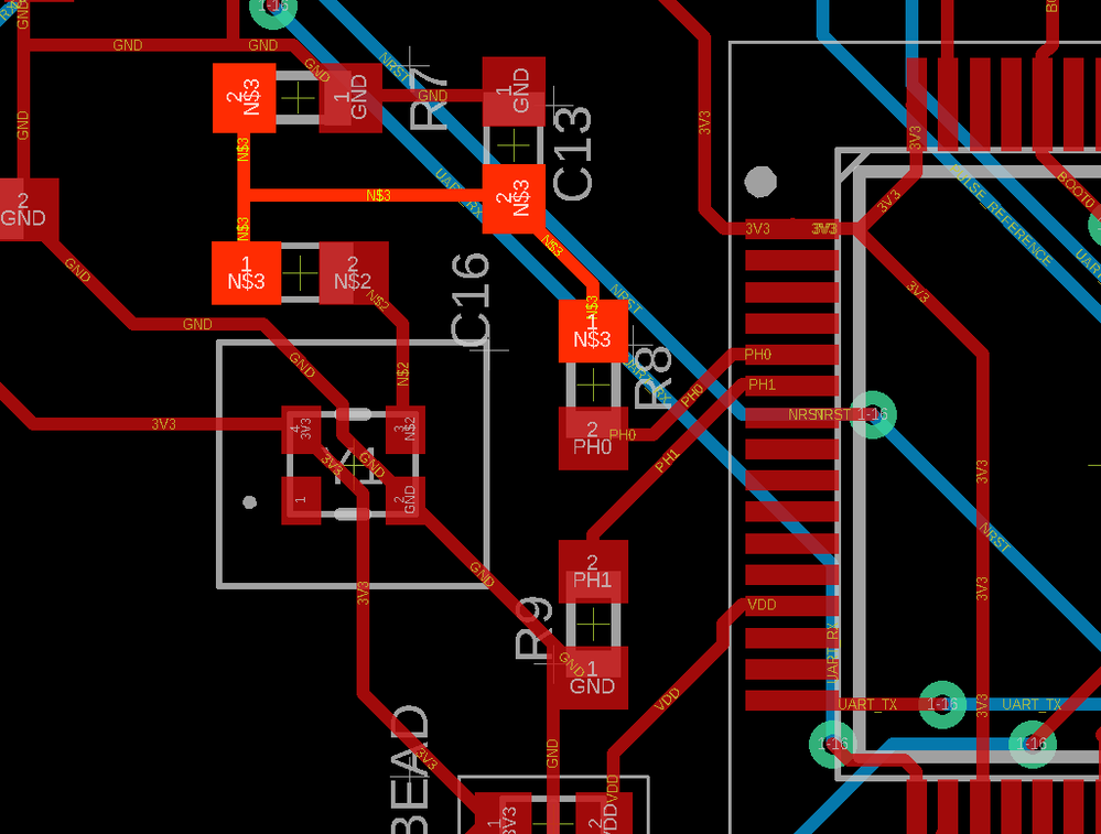

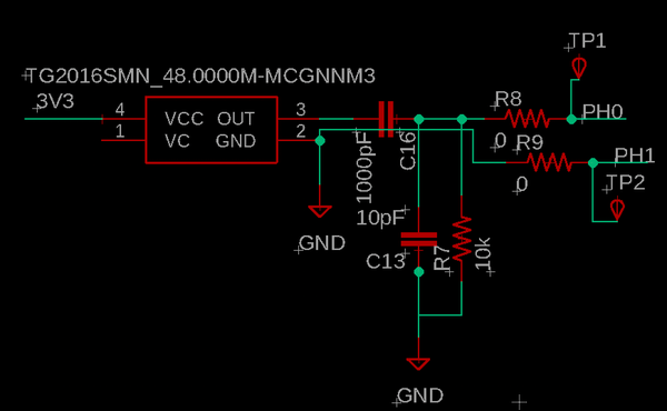

I’m designing a board with the STM32F401RBT6 and have decided to use a 48 MHz TCXO for the HSE clock.
I’ve written a simple "Hello World" program that communicates through USART.
the TCXO i used : TG2016SMN 48.0000M-MCGNNM3
Observations: When using the HSI (internal oscillator), the program works fine. When switching to the HSE (with the TCXO), the program does not work. I measured the TCXO OUTPUT SIGNAL using an oscilloscope. The waveform is shown in the attached image.
value of R8 and R9 = 0 , C13 = 10 pF , C16 = 1000pF
What could be causing the program to fail with the HSE clock? Are there any specific considerations or configurations required to use a TCXO with the HSE input on this MCU?

1) Can You try to remove R9 so to leave PH1 Open .

Additionally, I have attached my complete code and the schematic of my setup for your reference.

With MCU capacitor on OUT is fail. Replace C16 with 0-33R

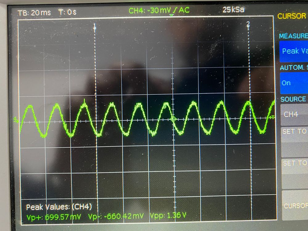

The timebase on your oscilloscope is set to 20ms / division. That will not show 48MHz.
What you are showing is the waveform aliased-down by the 25000 samples per second sampling-rate that your oscilloscope uses when running at such a slow timebase.
You need to increase the oscilloscope timebase to something like 0.1 microseconds per division to have a hope of seeing the waveform (or better 0.02 microseconds per division if your oscilloscope will go that fast).
And the other thing is that the voltage you present to PH0 needs to swing from below 0.3 x Vdd to above 0.7 x Vdd, so that means that at a typical 3.3V supply it needs to swing from below 0.99V to above 2.31V.
The schematic shows you AC-coupling the output of the oscillator and biasing it around 0.0V (C16 and R7). And then C13 attenuates the signal. This will not work.
Remove all three of those components. Instead of C16 fit a resistor (you can use R7 if that's convenient).

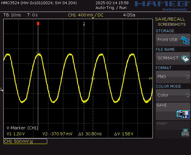

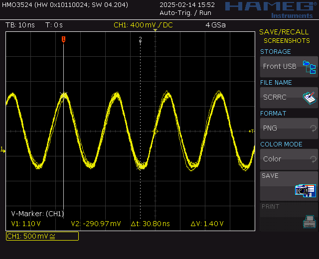

2025-02-15 3:45 AM
Thank you for your detailed explanation! I tested this on two boards:
Would you have any suggestions on how I could improve this further? I really appreciate your guidance! :smiling_face_with_smiling_eyes:
removed C16, C13, and R7
only removed C16 and kept R7 and C13
2025-02-15 4:19 AM
Primary switch scope to 1:10
1:1 is limited around to 10MHz
And still your connection to MCU is fail. For active TCXO R9 / PH1 must be unconnected
2025-02-15 4:22 AM
thank you for your response, R9 is already removed in both boards and i I have enabled HSE and set it to bypass mode.
