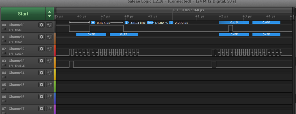

#define SPIx_NSS_Mode GPIO_MODE_AF_PP
#define SPIx_NSS_Pull GPIO_PULLUPWithout Daisy, waveform(below)

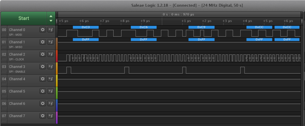

With daisy waveform(below)
in the above picture NSS is coming in between.

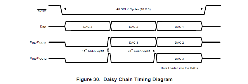

}please help to achieve like below

NSS is not a CS signal. In TI mode, it is high for the first byte in a transfer. Since your data size is 16 bits, it is high for the first bit, then low for the remaining 15 bits. This isn't what you want.
Set up the SYNC signal as a GPIO output and control it manually. Set it low before each transfer and high after.

Disabled TI mode and GPIO is used to control the NSS signal (manually).
This solved my issue.
