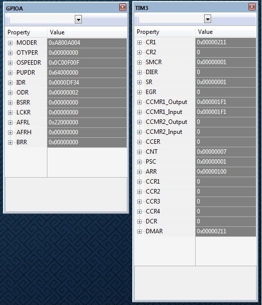

#1 I apply the clock at PA.6 configured as alternate function 2. Then the CCMR1 is configured for IC1-TI1. When I toggle the clock signal I see change the bit6 in PA IDR register so no hardware connection error happen. In this condition and with SMS=001 the count change (increment o decrement) instead RM0090 say ''Counter counts up/down on TI2FP2 edge''.
#2 the problem is not spurious count at startup but the counting direction that depend of the initial level of the clock signal.
Why
does it happen?
How do I
know
the internal state
This is may Main code and register value at runtime.

Posted on March 21, 2014 at 19:03
Why
does it happen?
How do I
know
the internal state
I don't know, it's not how the functionality is described. The documentation for the TIM units is not particularly good, and the block diagrams lack detail. I'd prefer to see some more gate-level stuff, it would be less ambiguous.
These TIM operations are somewhat outside my purview.
