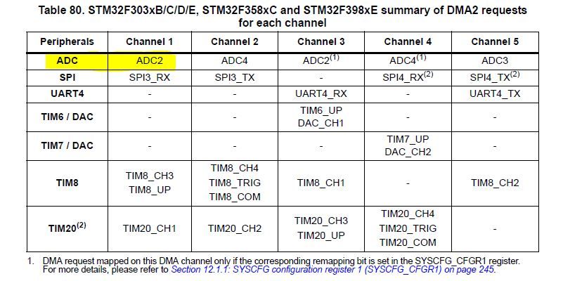

DMA_InitStructure.DMA_PeripheralBaseAddr = (uint32_t)&ADC2->DR;

DMA_Init(DMA2_Channel1, &DMA_InitStructure);
