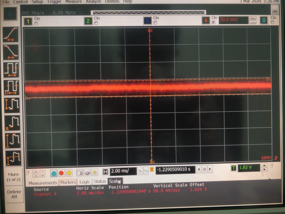

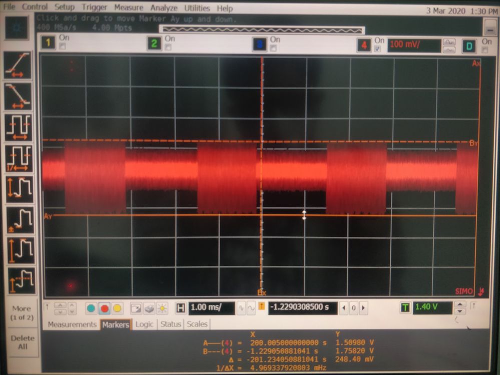

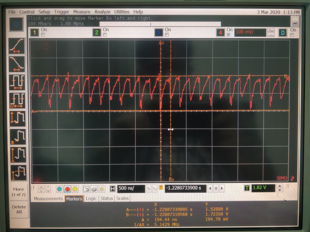

If I connect the PA4 to PA1 using a jumper, during the ADC capture, there will be a huge disturbance in PA4, about 248mVpp with 5.14MHz frequency.
If stop the ADC capture or remove the jumper connection, there will be no these disturbances.

The ADC works as a capacitor with a few pF capacity (value specified in the datasheet), charged to half of VREF, which is at the beginning of the sampling phase connected to the input.
The DAC has a significant output impedance (depending on whether its output buffer is switched on or not). Again, for the particular value resort to the datasheet.
These two factors determine the "dip" in the input signal at the beginning of the ADC sampling phase.

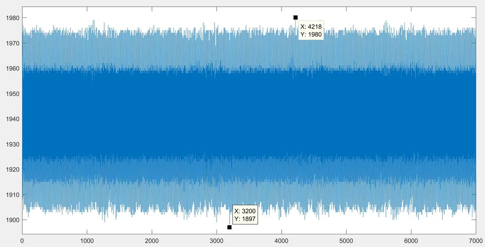

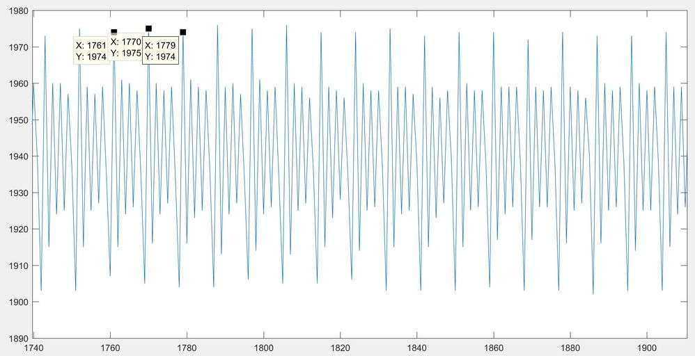

The output buffer is enabled. But the captured ADC data also has a huge noise about 83 code(peak-peak).
This doesn't make sense.
