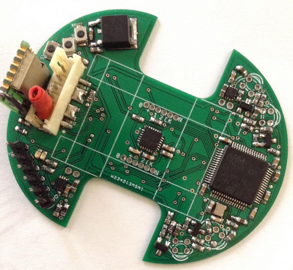

Posted on May 01, 2018 at 18:30
Do you have any capacitor on that NRST?
Post a photo of the board.
Posted on May 01, 2018 at 19:40
I have a capacitor, but the problem persisted even after removing it from the board. There are no visible problems with the soldering. I sort of circumwent the problem by changing the 10k pull-up resistor to 1k. There is a voltage drop of around 0.9V across it, which is still a high input so the mcu runs continously. As far as i know the NRST is a high impedance input, so the current must be flowing elsewhere. Is this assumption correct?
What is weird that there is no resistor that in series with the pull up could cause such a voltage drop.
The board is kind of small, I dont know if anything is visible on it. There are no components on the bottom side. Please note that I'm a begginer at soldering, but criticism is welcome.0690X00000604dRQAQ.jpg
Barely visible reset sign at the most right button. Right after it there is a decoupling capacitor, and net to the connector there is the 1k pull up. Pin 7 is NRST, also conncected to the jtag connector (black one on the lower left). MCU pin numbering starts on the lower side.
Bottom layer is only wiring, very clean, no soldering at all.
There are some solder bridges but only where the closely packed components are connected anyway.
Bence
Posted on May 01, 2018 at 22:00
Nice board.
No.
From DS, Table 12. Legend/abbreviations used in the pinout table:
RST Bidirectional reset pin with embedded weak pull-up resistor
and then under 6.3.15  NRST pin characteristics you'll find the NRST pullup value, which is typ. 40kOhm.
So the described behaviour doesn't make sense, and it's time for desperate measures:
- isn't reset connected to the radio board, and/or to the white connector, or to any other circuit? Can you disconnect all?
- check for the third time all the power and ground pins (btw. how is VBAT connected? This IMO can't be reason for problems, but one never knows)
- resolder pin 7
- measure for shorts to every neighbouring pin and trace
- wash thoroughly the board to remove any chemicals traces
- cut the trace from pin 7
The mcu may be damaged too, so you may need to change it, but I'd leave it as a last-resort solution.
