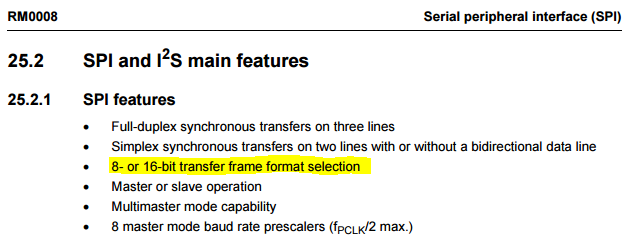

replied, this family of micros don't have the feature of select any other frame size as you can check in the reference manual:I faced the same issue trying to transmit a 25bit frame, So as

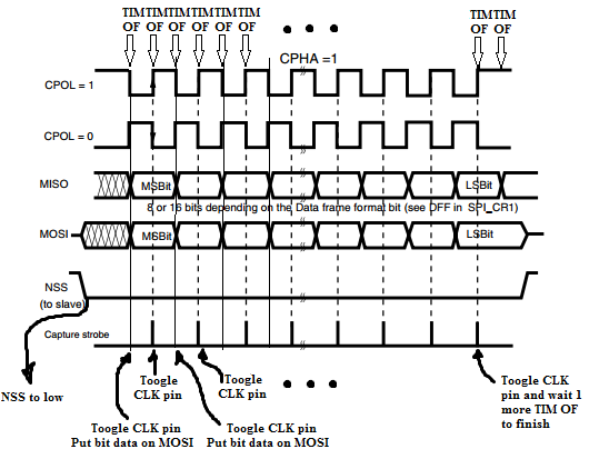

recommended to you, you should implement a manually spi. I suggest to use a timer configured in with a period equal to the half of the frequency period and use the timer overflows, configure 3 pins as GPIO output for clock, mosi and nss and make the following:It works for me.
