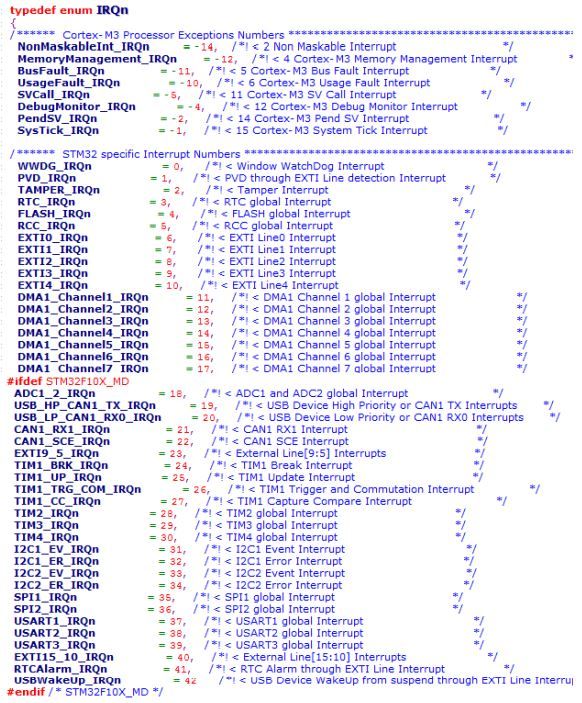

Currently I'm trying to understand about STM32F10x's interrupt.So I've got some snippet code as the below,USART1's IRQ number is 37.

There are 16 slots for 'System Handlers' which are generated via the SCB, the remaining interrupts are generated via the NVIC. The NVIC design maximum is 240 interrupts. ie 240+16 = 256
Each 32-bit register is 4 bytes wide, this is where the *4 comes from. The USART1 interrupt is number 37, and has to index past the 16 system handlers in the vector table, thus the addition.

The priority registers in the NVIC are 8-bit wide, the USART1 priority is 37 bytes into the priority register array.

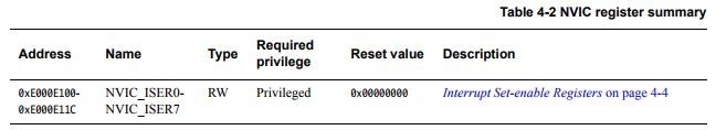

The 37/32 gets you an offset into a 32-bit register file, the *4 gets you from a byte index to a word index, the bitpos 37%32 gets you a bit position within the selected 32-bit register holding the enable bit.
Look at the NVIC documentation in the ARM Technical Reference Manual for the Cortex-M3, understand the bit, byte and word representation of registers with the processors address space.

I came across the below such as Interrupt Set-enable Register.
and There are 8 Interrupt set-enable registers NVIC_ISER0~7.
But I'm wondering what if I want use interrupt function then should I have to choice the one of 8 registers?
How can we know which NVIC_ISERx should we have to use?
