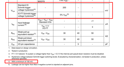

2024-09-12 1:27 AM
The general problem with datasheet parameters is, that they usually don't tell, whether it's a requirement on the user or a guarantee by the manufacturer. In this case, the VIL/VIH values are requirements on the user, i.e. VIL=max.1.136V means, that "if you want the pin to detect low, you must not put more than 1.136V on it".
What you are looking for is the hysteresis value:
