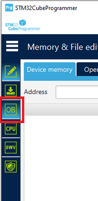

As it could be something related to the option bytes (different values). You can check and compare the content of the option bytes using STM32CubeProgrammer tool going to OB menu:
