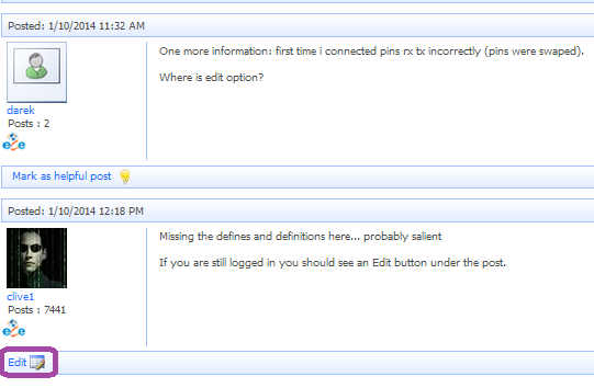

2014-01-10 2:32 AM
One more information: first time i connected pins rx tx incorrectly (pins were swaped).
Where is edit option?2014-01-10 3:18 AM
Missing the defines and definitions here... probably salient
If you are still logged in you should see an Edit button under the post.2014-01-10 3:21 AM
