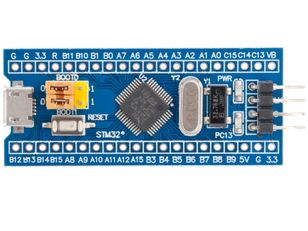

1- Please use </> button to paste your code. See this post. I've already edited your post.
2- Are you using this board?:
