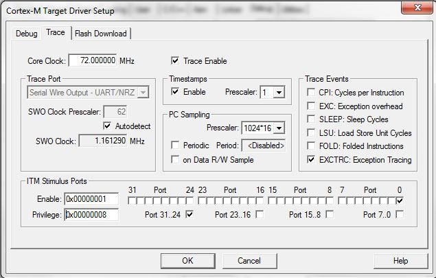

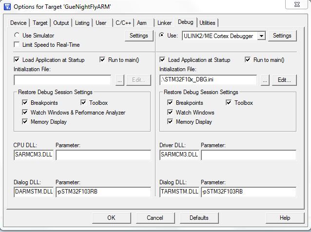

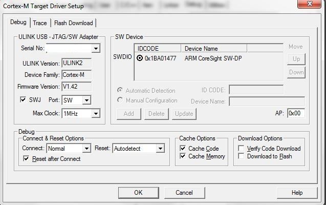

First of all debugging window :
Added to this configuration I have inserted the redirection of fputc :

} Finally after checking many samples and the documentation, I have made an .ini File (see above) which is used at debug startup :

Now when I use printf in my software, it will pass on the instruction and get into putc function, but nothing will come out on the debug printf in Keil.
If anyone has an idea of what could cause this, that would be VERY appreciated :)
