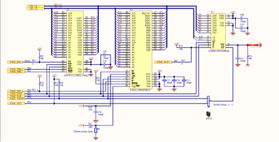

We have designed a board that we used STM32F103ZGT6.
We have used FSMC with following specifications
- On NE1 - NOR FLASH (M29W640GT)
- On NE2 - SRAM (Renesas RMLV1616 series)
Everything is clear and normal for SRAM. We can read&write successfully.
But We could not access to flash memory.
We have tested 5 different board
What is wrong?
Is there any problem to use both SRAM and NOR flash in same project?

2024-05-02 10:57 PM
Actually the connections are same as STM32-EVAL (STM32F103ZE)
We have just forgotten to use pull up resistor for CE (NEx) pins with 10K resistor
In our current design
NE1 for NOR Flash
NE2 for SRAM
As I said you before everything is ok for SRAM
Regarding NOR Flash
Here is the code for initialization. I have changed some values for timing. But no more change.
Sometimes We read FF values for the bytes. But could not program flash.
Sometimes We read random values from Flash
Sometimes The code is waiting in undefined state.

2024-05-02 10:59 PM
Yes actually We have designed our board according to STM32-EVAL board which you have referenced.
We just forgotten pull upresistors for chip enable pins (NE1 and NE2)
I have configured both SRAM and NOR flash.
Actually I have tested the flash only (without SRAM), no change
