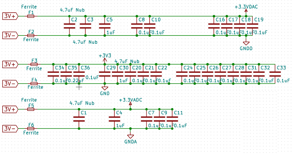

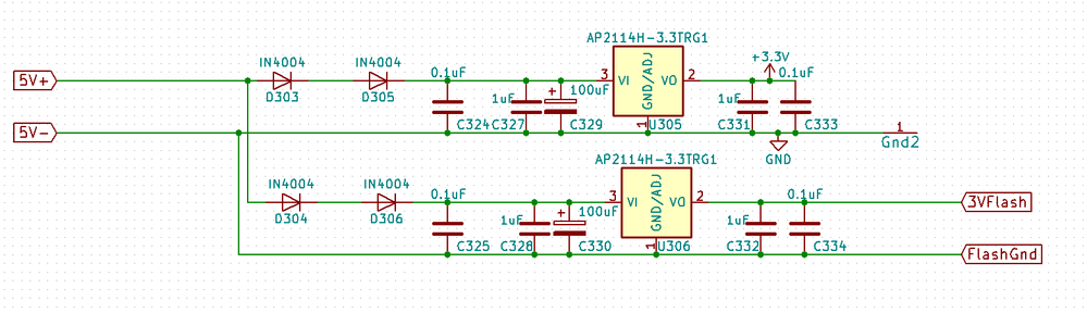

I use this circuit to remove the noisy parts from the processor.
I use SMC diodes to dissipate 1.2V headroom reducing the heat in the 3v3 reg by 60%
These PNP type regulators will work down to 200mV headroom and supply up to 1A
Otherwise you can use the same Regulator and Ferrites to isolate the noise.
