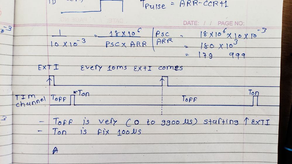

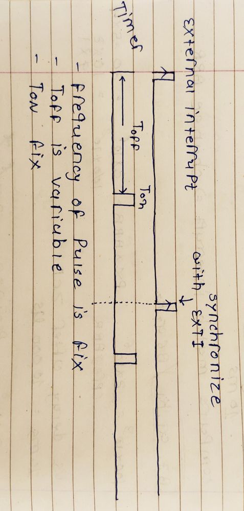

total time of pulse(on+off) is (10ms = 10,000 us).
now pulse on time is fix let say 10 us.
now i need to very off time between( 0-9,990 us).
for exampe: OFF-ON-OFF , ON-OFF, OFF-ON (here total time 10ms on time fix 10us)
and every 10 ms external interrupt comes so i need to reset counter back to 0 for synchronous operation with external interrupt.
that is my requirement.

2020-03-06 12:56 AM
I don't quite understand, please draw a timing diagram.

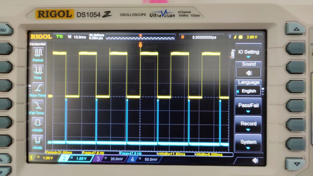

2020-03-20 3:56 AM
i tried code as you say it works fine but i don't get my desired out put so where is my mistake.
code i tried is below.

HAL_TIM_OnePulse_Start(&htim1,TIM_CHANNEL_1);
using above code i got as op(yellow).
Here i want as out put waveform.
in idle state timer CH1 op remain HIGH . but here no effect of setting idle op SET & RESET in code.
