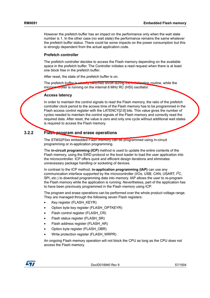

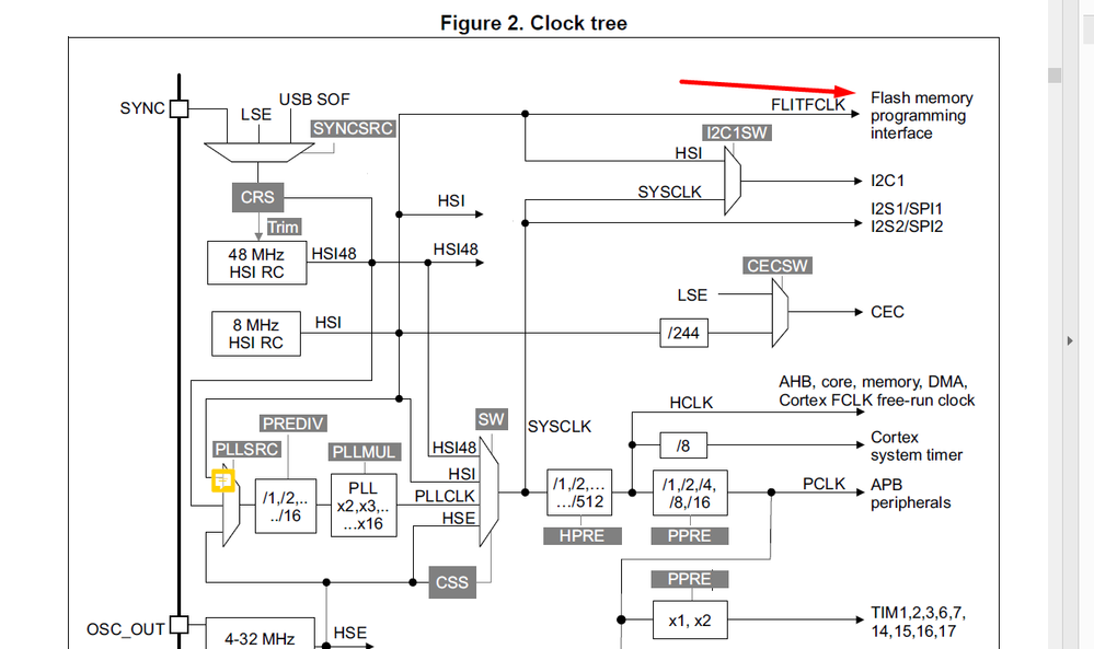

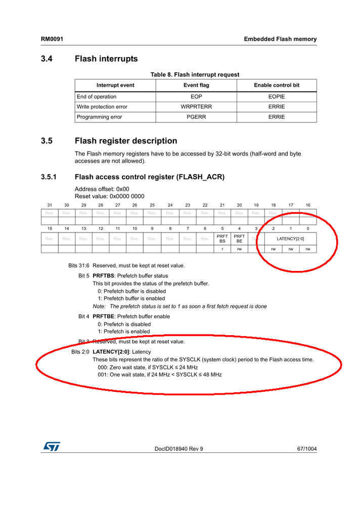

> and how do you change the flash latency?
0693W00000LyR7cQAF.png0693W00000LyR9JQAV.pngJW
I finaly succeed to set a 48Mhz clock but now the code seem work only in debug is latency can cause that problème?
i'm trying to change the latency to see if it work
OK i finaly found how to set the latency and that seem like to work
thank you for your help waclawek.jan  ,have a nice day !
