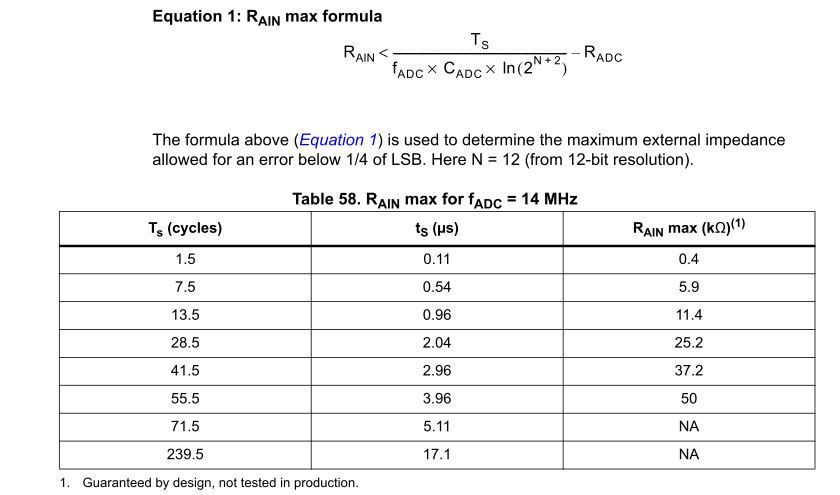

Also, the data sheet specifies the maximum external input impedance which is allowed. For sampling time of 5usec and above, the value of RAIN is referred as NA. Does it mean that the external input impedance does not matter for sampling time of 5usec and above?

The source/input must be able to charge up the Sample&Hold capacitor in the given (sample) time, else you will see either a step-wise approximation of the actual value.
With multiple, multiplexed channels, the value seems 'dragged' towards the previously converted channel value.
The whole setup can easily approximated and calculated with a RC element (input impedance and S&H capacitor).
I think they bravely omitted the calculation.
While 50kOhm is no problem for the most mediocre opamp, you cannot connect e.g. high-impedance sensors to the ADC inputs directly.
A noisy and/or unstable VDDA would account for large variance in ADC results.
VDDA should be buffered separately from VDD.

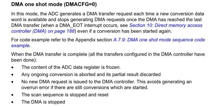

Thank you for the explanation. It was very helpful. I had an additional query. I am currently reading 6 analog channels using the DMA one shot mode. The DISCEN=0  and CONT= 0(I am sampling multiple channels in single conversion mode) .The data sheet says that, after the scan sequence the DMA is stopped. Does that mean that the DMAEN bit of the ADC_CFGR1 register becomes 0 or the EN bit of the DMA_CCR1 goes 0? However, I don't find any one of them go 0 in the watch window.
