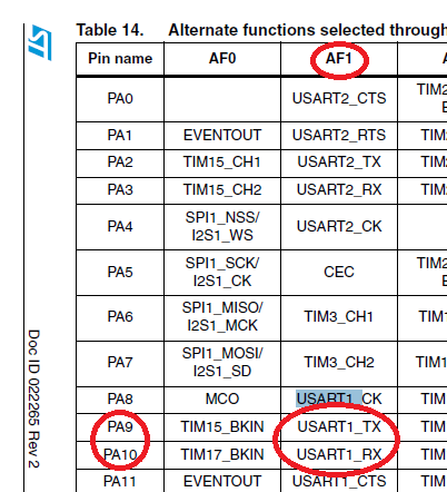

Hi, I'm switching from a stm32f100 to the stm32f051, most of the code is working already. but the usart1 does not work. The output doesn't change when I am trying to send something.
Here are some snippets of my code:
1.
RCC_USARTCLKConfig(RCC_USART1CLK_PCLK);
2.
RCC_AHBPeriphClockCmd(RCC_AHBPeriph_GPIOA | RCC_AHBPeriph_GPIOB);
3.
RCC_APB2PeriphClockCmd(RCC_APB2Periph_ADC1 | RCC_APB2Periph_USART1, ENABLE);
GPIO_InitTypeDef GPIO_InitStructure;
GPIO_InitStructure.GPIO_Speed = GPIO_Speed_50MHz;
GPIO_InitStructure.GPIO_OType = GPIO_OType_PP;
GPIO_InitStructure.GPIO_PuPd = GPIO_PuPd_NOPULL;
/* Configure USART1 RX (PA.10) as input floating */
GPIO_PinAFConfig(GPIOA, GPIO_PinSource10, GPIO_AF_0);
GPIO_InitStructure.GPIO_Pin = GPIO_Pin_10;
GPIO_InitStructure.GPIO_Mode = GPIO_Mode_AF;
GPIO_InitStructure.GPIO_PuPd = GPIO_PuPd_UP;
GPIO_Init(GPIOA, &GPIO_InitStructure);
/* Configure USART1 TX (PA.9) as alternate function push-pull */
GPIO_PinAFConfig(GPIOA, GPIO_PinSource9, GPIO_AF_0);
GPIO_InitStructure.GPIO_Pin = GPIO_Pin_9;
USART_InitTypeDef USART_InitStructure;
USART_DeInit(USART1);
/* USARTx configured as follow:
- BaudRate = 115200 baud
- Word Length = 8 Bits
- One Stop Bit
- No parity
- Hardware flow control disabled (RTS and CTS signals)
- Receive and transmit enabled
USART_InitStructure.USART_BaudRate = 115200;
USART_InitStructure.USART_WordLength = USART_WordLength_8b;
USART_InitStructure.USART_StopBits = USART_StopBits_1;
USART_InitStructure.USART_Parity = USART_Parity_No;
USART_InitStructure.USART_HardwareFlowControl = USART_HardwareFlowControl_None;
USART_InitStructure.USART_Mode = USART_Mode_Rx | USART_Mode_Tx;
/* Configure USART1 */
USART_Init(USART1, &USART_InitStructure);
/* Enable the USART1 */
USART_Cmd(USART1, ENABLE);
/* Enable USART1 Receive interrupt */
USART_ITConfig(USART1, USART_IT_RXNE, ENABLE);
Can anyone tell me, if there is a problem with the initalization?
Thank you for every help.

2013-02-25 9:39 AM
For USART1, this should be workable
/* USART1 PA.9 Tx, PA.10 Rx STM32F0-Discovery sourcer32@gmail.com */
#include ''stm32f0xx.h''
#include ''stm32f0_discovery.h''
int main(void)
RCC_AHBPeriphClockCmd(RCC_AHBPeriph_GPIOA, ENABLE);
RCC_APB2PeriphClockCmd(RCC_APB2Periph_USART1,ENABLE);
GPIO_PinAFConfig(GPIOA, GPIO_PinSource9, GPIO_AF_1);
GPIO_PinAFConfig(GPIOA, GPIO_PinSource10, GPIO_AF_1);
/* Configure USART1 pins: Rx and Tx ----------------------------*/
GPIO_InitStructure.GPIO_Pin = GPIO_Pin_9 | GPIO_Pin_10;
USART_InitStructure.USART_BaudRate = 9600;
USART_Cmd(USART1,ENABLE);
while(1)
while (USART_GetFlagStatus(USART1, USART_FLAG_TXE) == RESET);
USART_SendData(USART1, 'X');

2013-02-26 12:18 AM
Thank you very much.
Now it works - there was just the failure with the alternative function table.We’re moving the ST Community to a new platform to give you a better and more reliable community experience.
