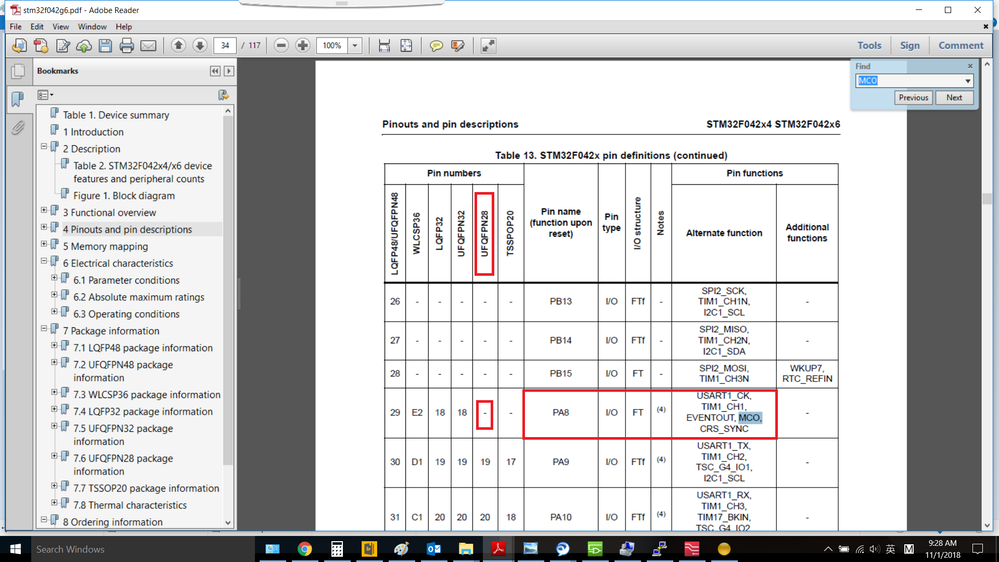

1,only use PA9 and PA10 for USB; PA1~PA3 for RS485; PA15,PB3~PB5 to control 4 LEDs.
2,STM32F042G6U6 (UFQFPN28) have no PA8(MCO) pin.

1,STM32F042G6U6 (UFQFPN28) have no PA8(MCO) pin,please check the datasheet,
