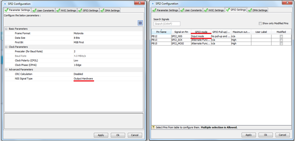

I play with
STM32Cube
and
I'm a little
confused
. I create project for STM32F103RB In Pinout select SPI2 Half-Duplex Master and hardware NSS Signal In SPI configuration is NSS Signal Type as Output Hardware, but in GPIO Setiing is GPIO Mode Input mode.I'm confused_

Dear user,
Thank you for reporting the issue. This will be fixed in a next release. When enabling NSS by hardware, they are two modes: output enabled (MX configuration window calls it ''output hardware'') and output disabled (MX says ''input hardware''). The GPIO mode should be aligned: output when output is enabled, input when output is disabled. For now, you will have to change the GPIO mode settings manually. Best regards2016-03-22 11:46 AM
Dear user,
This has been solved in 4.13. Best regardsWe’re moving the ST Community to a new platform to give you a better and more reliable community experience.
