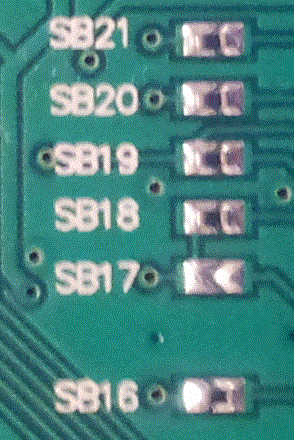

Hi there
According tohttp://www.st.com/st-web-ui/static/active/en/resource/technical/document/user_manual/DM00050135.pdf
PF0 is configured as GPIO.I didn't change any solder bridge settings but I cannot get access to PF0 as GPIO.PF1 works OK, PF0 doesn't.. the same configuration for both.I've tested it with three brand new boards.Any idea how to solve it?J. #rainbows-and-unicorns2013-08-27 11:30 AM
Why not? You'll need to remove SB18 to stop getting an 8 MHz signal from the ST-LINK's F103, and you'll need to make SB17 to get it too the external pin frame.2013-08-27 2:47 PM
PF0 and PF1 can be used as GPIO or as HSE oscillator. By default these I/Os are
configured as GPIO, so SB16 and SB17 are closed, SB18 is open and R22, R23, C13 and
C14 are not populated.
I undestand SB18 is open by default.Edit:I've checked it - all SB 16 to 18 were open.
2013-08-27 5:39 PM
That certainly deviates from the boards in my possession.
