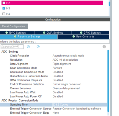

2023-12-22 1:19 AM - edited 2023-12-22 1:20 AM
Hello @brian-o ,
Thank you for sharing your code ! For your information, there's a button for a better code display, don't hesitate to use it next time (you can check the picture below) :)
Regarding the issue :
Best Regards,
Pierre
