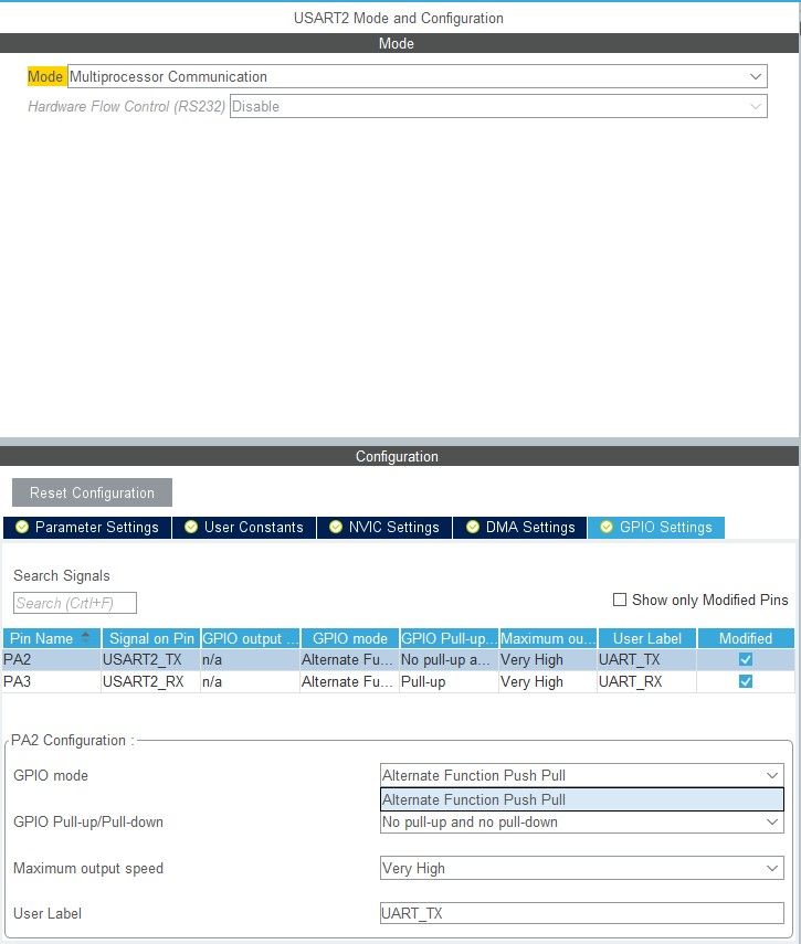

I'd like to use USART for multiprocessor communication. For this I have to configure the TX pin to an open drain mode. But this option is not available:
MCU: STM32F446ZEH6
STM32CubeMX: 5.1.0

Thanks, I know about this. But manual changes will be lost every time when I generate code with CubeMX. Is there any other option?

Yes, but that will cause an unwanted voltage glitch on the pin, because it will be configured 2 times.
Is there a way to modify any CubeMX configuration file to get this option? If not, then, would be good that this bug will be fixed in future release.
