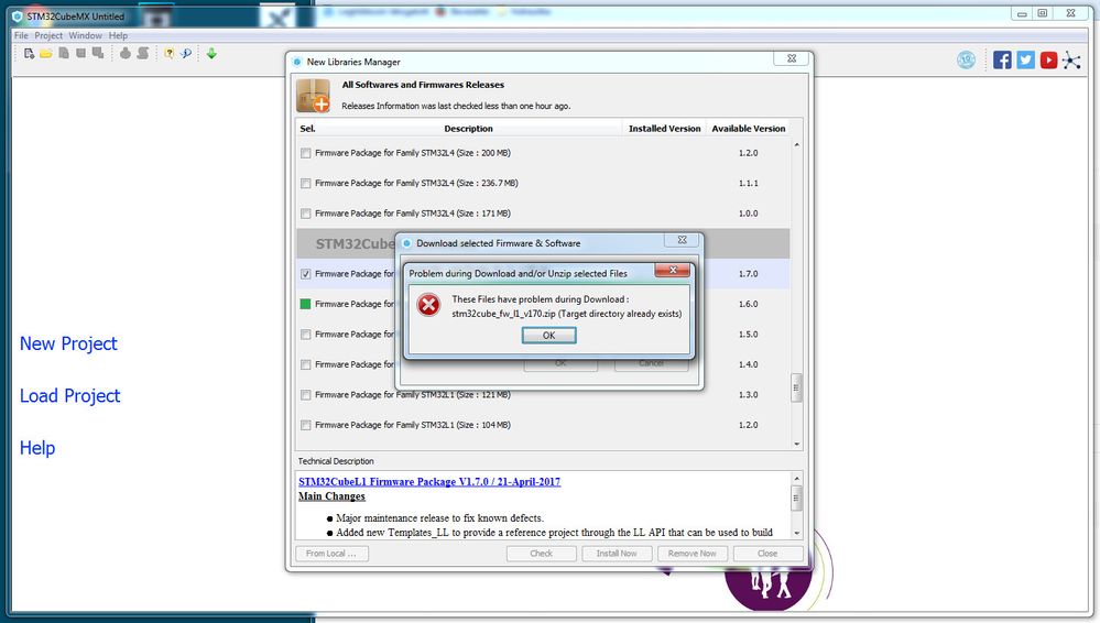

I have the same issue with STM32L1 V1.7.0 It can't be a temporary server failure, because I tried it abt 5 times in the last months (couple days between attempts). Lots of other updates have been installed successfully since then, but this L1 v1.7.0 always fails (v1.6.0 is up and running)
