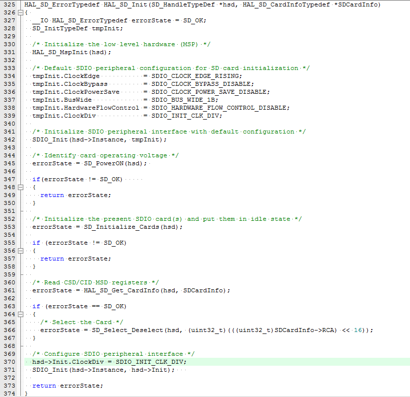

Just a bit of an update. Although I though I was lowering the clock speed of the SD clock by changing the SDIO_TRANSFER_CLK_DIV define. It was actually being set to 24Mhz before leaving the HAL_SD_Init function. This happens right before the return at SDIO_Init(hsd->Instance, hsd->Init);
The hsd->Init struct contains all 0's so the ClockDiv field is getting set to 0, so clock is being set to 48Mhz/(0+2) = 24Mhz.I added the line hsd->Init.ClockDiv = SDIO_INIT_CLK_DIV; (Line 370) just before the SDIO_Init at the end of the HAL_SD_Init function to keep the clock speed at 400kHz. I also have SDIO_TRANSFER_CLK_DIV (stm32f4xx_ll_sdmmc.h) set to 0x76 ( 400kHz ) for my testing also.All operations seem to be now working at this speed, no more CRC or timeout errors. I have a temporary SD card wired to the F4 discovery board and my wiring may be too long but at least I can work from this working low clock speed and figure out the rest. Hope this helps someone, I've been a few days trying to figure out why it wasn't working.2014-06-06 10:33 AM
