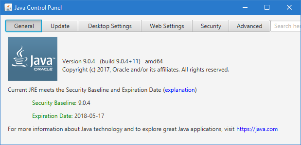

Using Java version 8 I have no problem with CubeMx. When I fully uninstall Java 8 and install only Java 9 I'm getting such error:
This problem can be solved only by programmers of CubeMX by compiling it for using Java 9. This problem is known for every software developers that must support new java version.
My version of Java is:
Regards

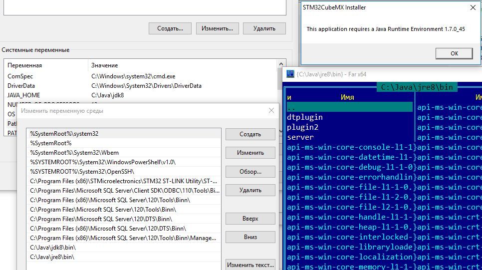

2018-11-28 1:27 PM
I use java8. It does not work!
2018-11-28 4:00 PM
here's a better suggestion - bundle the appropriate JRE with the application, like many other developers do.
2018-11-29 1:34 AM
I'm just trying to run the installation. What kind of application is it that he needs to dance with a tambourine to install it? I dont know where to search for java7. Installation redirects me to java8 page.
