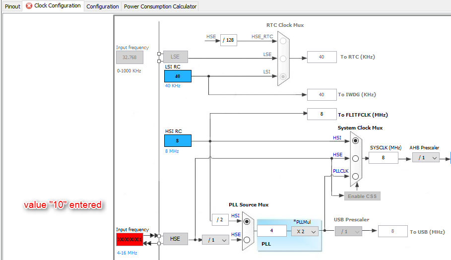

The Clock Configuration GUI shows a weird behavior: I'm not able to put a valid input frequency for HSE (or LSE).
For example I want to setup the input frequency to 8 MHz:
  • entered value 8 is not accepted - changed to 0.0000000000080 immediately0690X00000606ogQAA.png

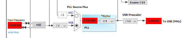

  • entered value 8000000 is accepted and changed to value 8 but as soon as the focus is changed to an other element the value jumps to 0.0000080 0690X00000606qCQAQ.png

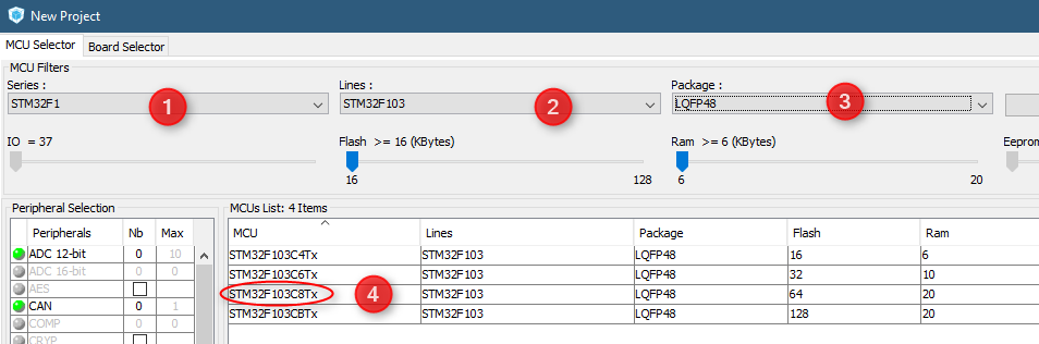

create new project
enable High Speed Clock
Default clock setting shown good as expected

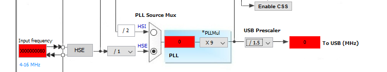

but as soon I change the default value the GUI shows wrong values
clock values entered in Hz (e.g. 10000000) are temporarily accepted as 10 MHz but as soon as I change the focus (activate another element) the entered value becomes invalid.
