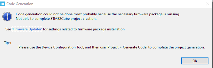

I am using the STMCubeIDE version 1.8.0

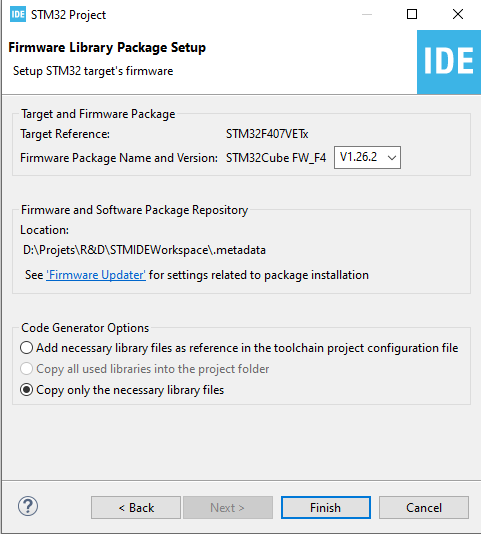

I try to create a STM project for a STM32f407VE
I get the error message as many users : the IDE does not find the 1.26.2 firware
I tried to follow the solution to install with the Import from local option, this does not work

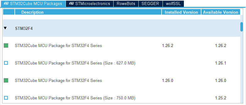

I tried to install and use the 1.26.0, the packages installs correctly in the "manage packages" but is not detected by the "create project" option (it tries to download it again)

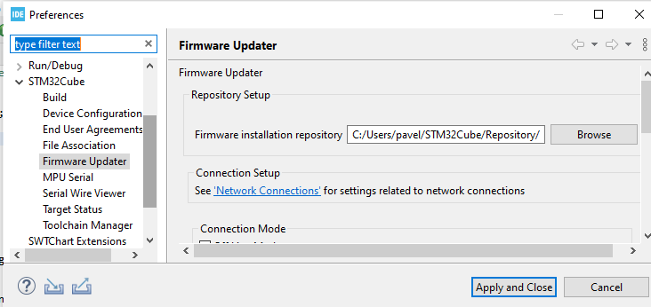

Check if instalation repository paths is without spaces, reinstall IDE without spaces or special characters in user name usw...

Please open Window->Preferences and then open the repository folder in Explorer
Do you see there subdirectory named STM32Cube_FW_H4_V1.26.0 or STM32Cube_FW_H4_V1.26.2 ?

The current situation is :
I tried installing also manually the zip files (by unzipping it in the repository) this doesn't work either.
I tried to remove all packages and let the wizard download and install, this doesn't work.

2021-12-01 3:05 AM

2021-12-01 4:28 AM
Ok I uninstalled the whole IDE and reinstalled it in the C root drive :(
and now it works.....
