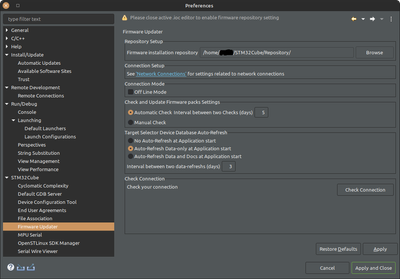

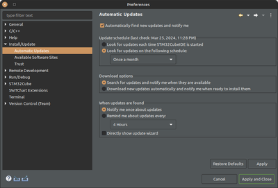

Have you tried these settings? Window->Preferences:
First time choose "Look for updates each time the tool is started". Then you might want to choose another schedule.
And this other too:
EDIT:
You can manually check for updates. In the main menu choose Help and then either (or both) "Check for target selector ..." and "Check for embedded ...". Both options have a blue MX icon.

But the above setting seems does not resolve my problem.
I tried reinstalling the lower version, but the result is the same.
But I installed the IDE on the other PC, it works well.
I have no idea what happened, and what to do next...
