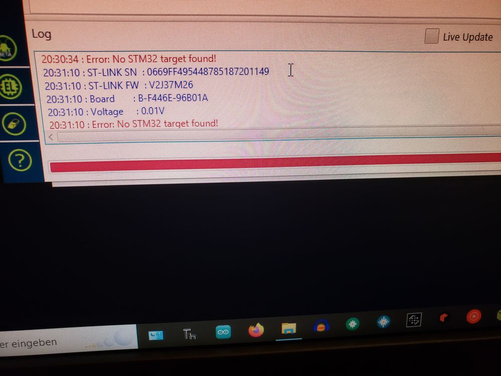

2022-12-11 4:37 PM
This is the message I get, when I connect the board to the PC.
It says: 0 Voltage.
What is wrong there?
2022-12-11 5:02 PM
This is an old board without a lot of resources.
Absent a schematic you'll have to trace the circuit, and compare with NUCLEO-64 series boards.
The failure suggests that the ST-LINK/V2 is not seeing a supply, or have connectivity with the STM32 part.
Suggest you review how the board is supposed to be powered, or what other board it expected to sit on top of.
Check jumpers or solder bridges, or if VIN can be powered.
2022-12-11 5:11 PM
https://www.96boards.org/product/stm32/
https://www.96boards.org/documentation/mezzanine/stm32/files/hw-manual.pdf
Reading the Manual suggests YOU need to provide 5V to the board
2022-12-12 3:47 AM
Hello, yea, you were very right. There is for instance the Dragon Board 410c, a SOC development board with Qualcomm processor, that hosts the board. This isn't a standalone board.
So all the problems came from a missing supply.
Thanks and goodby.
