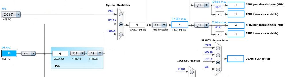

Hi Mayla,
sorry for late response. For my project I need to run USART1 from HSI or HSI/4. The reason for that is to be able to wake up from stop mode. I have chosen HSI/4 to lower the power consumption. Please see screenshot/code below for my System/USART clock configuration. Case 1) STM32CubeMX generated code setsHSI_VALUE to 4MHz: SystemCoreClock is wrong (set to 1MHz) USART works fine (baudrate calculated fromHSI_VALUE - 4MHz) Case 2) Manually set HSI_VALUE to 16MHz: SystemCoreClock is right (4MHz) USART doesn't work (baudrate calculated fromHSI_VALUE - 16MHz, but should be calculated from 4MHz value) Current baudrate setting doesn't differentiate between HSI and HSI/4. It simply usesHSI_VALUE to calculate the baudrate. Kind regards, Janvoid SystemClock_Config(void) {

2015-10-08 4:07 AM
Hi horcicka.jan,
What I want to say is that you have to set UART clock source to SYSCLK (select SYSCLK in ''USART1 Source Mux'' instead of ''HSI 16'').This way, when you manually fix the CubeMX generated value for HSI, the USART baudrate will be correct.-Mayla-To give better visibility on the answered topics, please click on Accept as Solution on the reply which solved your issue or answered your question.
