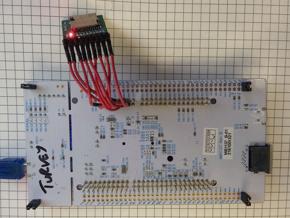

Banged my head on this working on the H743ZI-NUCLEO this morning, had been working via the VCP/USART3 and then started porting the SDMMC project. The symptom looked like an issue with HSE_VALUE so the first thing I checked. Likely other errors, pulled these two with a quick scan, but does highlight the need for more rigour in the releases here.
Didn't manage to get the SDMMC to work on the board, and did strip out the level converter stuff. Have pivoted back to the F767ZI-NUCLEO to get that working with the MicroSD socket to sanity check things.
The STM32H743I-EVAL arrived so will bang on that too.

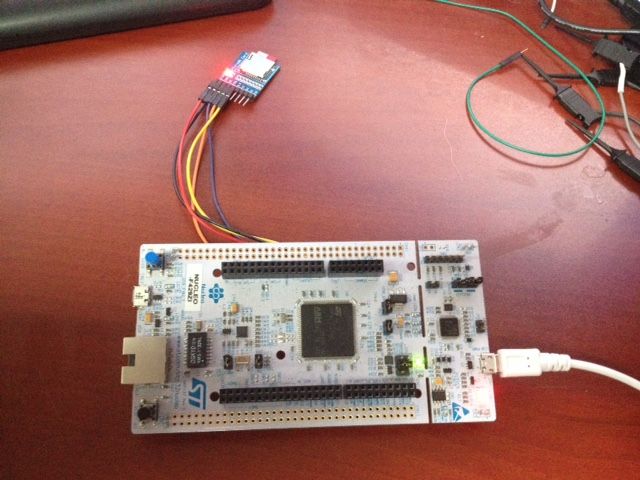

I'd picked up several of the ViewTool version
https://www.ebay.com/itm/1pcs-NEW-Micro-SD-Card-Module-Slot-Socket-Reader/272798769771
Nucleo F767ZI
Core=216000000, 216 MHzCPUID 411FC270 DEVID 451Cortex M7 r1p0STM32F76xxx or F77xxxC0000000 FFFFFFF8 0000000010110221 12000011 00000040FPU-D Single-precision and Double-precisionAPB1=54000000APB2=108000000FatFs Testing (68300)SystemCoreClock: 216000000Mounting FatFsFAT32 30.4 GB total drive space 30.3 GB available 100.3 MB used---- 113 /DIR.TXT---- 175 /LOG.TXTD--- 0 /RINEX---- 32768000 /SPEEDTST.BIND--- 0 /BASE_301---- 2494 /RINEX.INI32768000 Bytes, 524170395 Cycles 13.50 MBps Read (FatFs)32768000 Bytes, 524151419 Cycles 13.50 MBps Read (FatFs)4864 ms 13.47 MBps200005A0 512
CrcFile Size:32768000 BufferSize:512 32768000 CRC32:65744B39 PKZIP:9A8BB4C6 SPEEDTST.BIN200005A0 1024CrcFile Size:32768000 BufferSize:1024 32768000 CRC32:65744B39 PKZIP:9A8BB4C6 SPEEDTST.BIN200005A0 4096CrcFile Size:32768000 BufferSize:4096 32768000 CRC32:65744B39 PKZIP:9A8BB4C6 SPEEDTST.BIN200005A0 20480CrcFile Size:32768000 BufferSize:20480 32768000 CRC32:65744B39 PKZIP:9A8BB4C6 SPEEDTST.BIN200005A0 32768CrcFile Size:32768000 BufferSize:32768 32768000 CRC32:65744B39 PKZIP:9A8BB4C6 SPEEDTST.BIN200005A0 40960CrcFile Size:32768000 BufferSize:40960 32768000 CRC32:65744B39 PKZIP:9A8BB4C6 SPEEDTST.BIN200005A0 65536CrcFile Size:32768000 BufferSize:65536 32768000 CRC32:65744B39 PKZIP:9A8BB4C6 SPEEDTST.BINDone..Infinite loop...2018-04-23 9:21 AM
