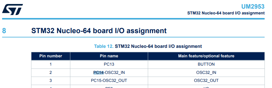

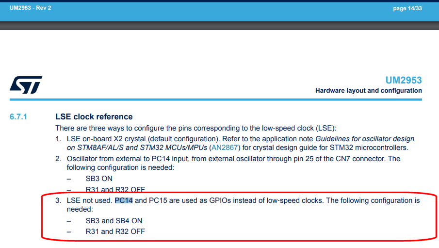

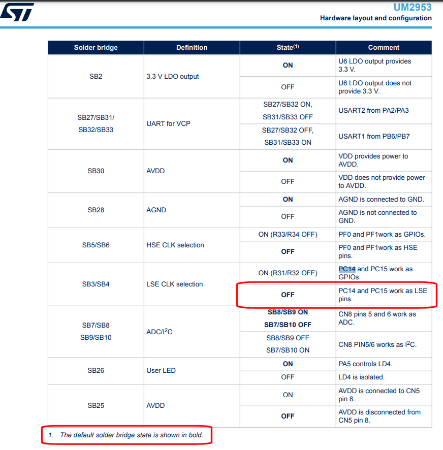

eg, take look at the User Manual:
2025-02-12 8:53 AM

This does not really apply in the second board that I described, I see from the schematics those are 0 ohm resistors that need to be placed and removed to actually access to PC14 on the pin header and disconnect the LSE. On my second board, there is literally a track that connects the two devices, and no LSE placed on that pin, so my question still stands.
