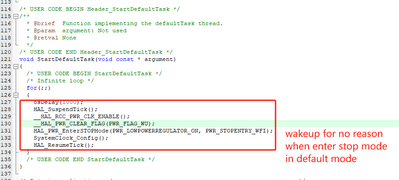

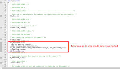

1. stm32F105 + stm32cubemx
2. project was created using freertos by stm32cubemx,no peripheral enabled,and config no use gpio as analog.
3. mcu can go to stop mode normally before os started
4. mcu wakeup for unknown reason when enter stop mode in default task

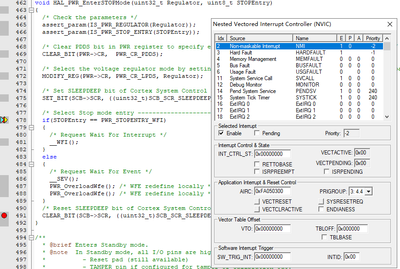

Hi Sarra:
Thanks for your reply.
1. I have add breakpoints to NMI interrupts ISR and foundno non-masked interrupt occus
2. before _WFI, no interrupt is on pending state
3. I know debug entry request would resume the stop mode ,but not for my situation
4. Code was generated by stm32cubemx, what I added was just enter stopmode code which was listed on my post.
