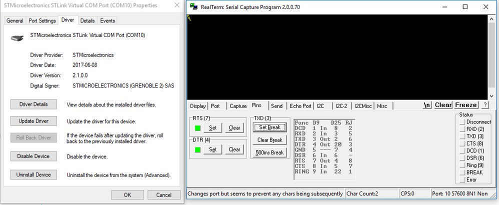

I have tried it on the STM32F3DISCOVERY and NUCLEO-F302R8 boards. Both have the same behavior.
If I press ''Set Break'' in RealTerm'' then PIN T_NRST (PB0) of the ST-LINK MCU (U2) assert low and
the MCU (STM32F30X) resets.2018-01-29 7:05 AM
Ok. It means that the st-link captures the ctr-c and resets the target MCU.
STM32F3DISCOVERY does not emulates the VCOM because of st-link v2 so the VCOM should not be seen in the Device Manager, I guess
NUCLEO-F302R8has the VCOM (st-link v2-1).
It does not explain the behavior.
2018-01-29 7:14 AM
Note that a break is not the same as a Ctrl+C ...
