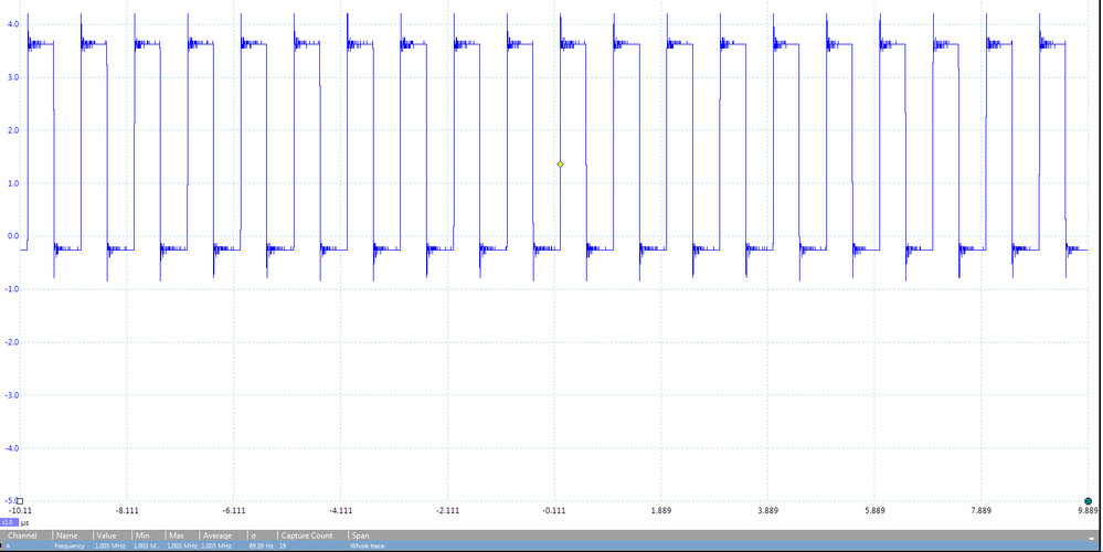

Hi everyone. I am using STM32F303RE and STM32L011 nucleo boards as a part of my experiment. I used STM32F303RE to generate PWM signal (in Interrupt mode) for 1MHz.
Clock Source - PLLCLK (8Mhz * 9 = 72 MHz).
Timer Period = 71
PWM pulse = 35 (for 50% duty cycle)
I used picoscope to measure the frequency. You can see the image below.

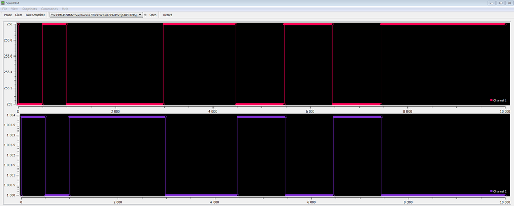

In Interrupt mode, i used CCR register to get the captures done. I read it through UART in serial plot.
As you can see, the timer misses a count. I don't know the problem behind this but this always happens. The timer always misses a count. I tested with different signals but got the same result. Even tried PWM with STM32L011 and captured in another controller, but the result is the same.

The numbers make sense if you see to the frequency that I have mentioned. I will state it more clearly for you.
freq = 256000 /capture; //freq in kHz. 8*32000kHz. As i have divided the input signal by 8.
now, for example, freq = 256000/255 (as mentioned in figure) = 1004 kHz (approx.)

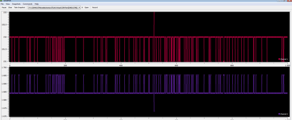

My project involves measuring the high frequency input signal ( upto 2 MHz). This is not from a PWM source but a different hardware setup. I already slowed it down using the division option from the timer, which i have mentioned already.
And for that if statement, it is absolutely necessary as I am not resetting the timer every time I encounter a rising/falling edge. It is necessary to take care of the overflow.

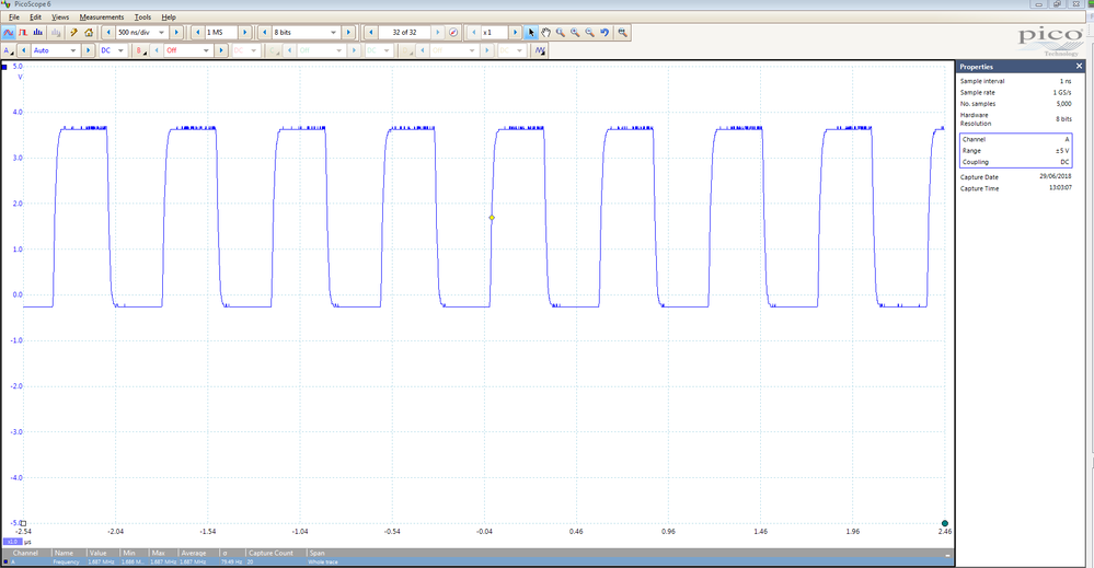

So, neglecting all the sarcasm, I wanted to know the problem faced because of the accuracy of the internal clocks. This occured when I tried to measure higher frequency. See the image below.
Now, the picoscope measurement of the same frequency.
As you can see, the counts are pretty much good but not accurate enough. There is always count miss of 1-2, whether it is a lower frequency or higher.
