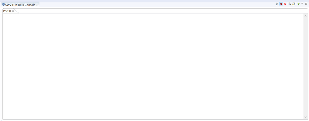

I'm new using stm32 microcontrollers, I have been trying to use the printf tracing in my code without success, anything is printed on the console . I can start a debug session, I can place breakpoints on my code, inspect variables and all works as expected but not the printf.

and ITM->PORT[0U].u8 = (uint8_t)ch; is being executed but no printf ouput in console.and ITM->PORT[0U].u8 = (uint8_t)ch; is being executed but no printf ouput in console.

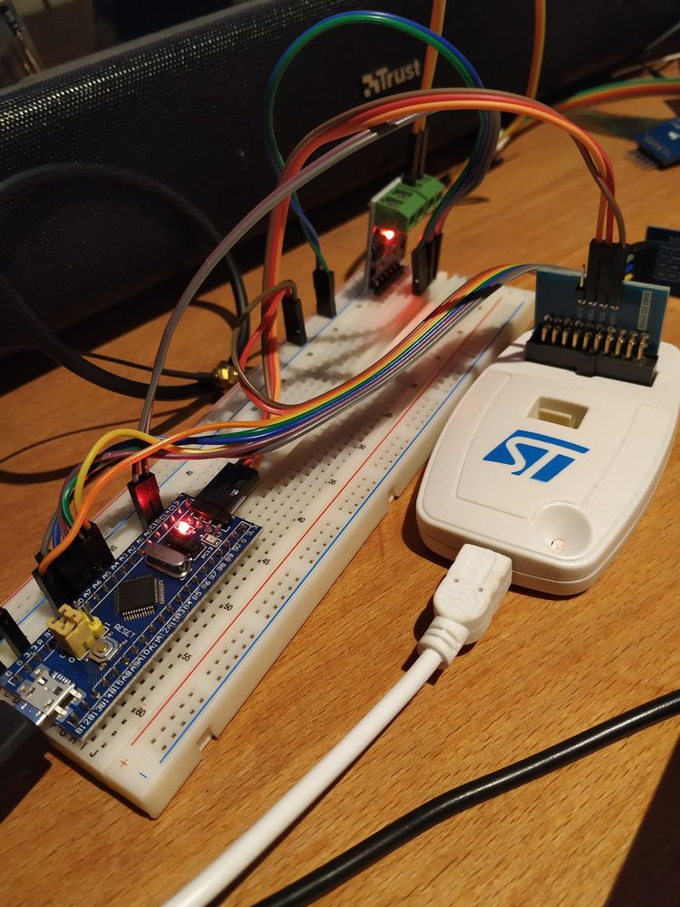

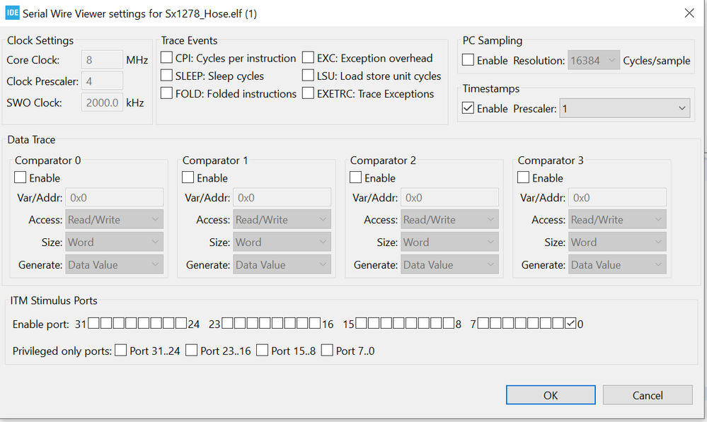

Core speed correct, really 8 MHz, not 72 MHz?
PB3/SWO pin wired?
2019-06-28 8:59 PM
I have tried both speeds, no luck either at 8 and 72Mhz.
PB3 ? I have conected PA14 and PA13
