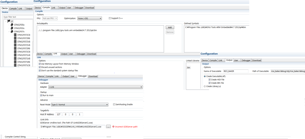

Dear All,
I want to have attention those who has experience on using coo-coox, I am writing here because coo-cox forum does not respond for successful logon.
My board is custom one build with centered 32F070RBTx,
The version is
CooCox CoIDE
Version: 1.7.8
Along withGNU Tools ARM Embedded\4.7 2012q4\bin, the following errors take place ,
[cc] arm-none-eabi-gcc -mcpu=cortex-m3 -mthumb -Wall -ffunction-sections -g -O0 -c ''-DC:\Program Files (x86)\GNU Tools ARM Embedded\4.7 2012q4\bin'' -IC:\STM32_toolchain\Workspace\Source_bak\cmsis_boot - [cc] from C:\STM32_toolchain\Workspace\Source_bak\common\Inc/stm32f0xx_hal_conf.h:184, [cc] from C:\STM32_toolchain\Workspace\Source_bak\common\Drivers\STM32F0xx_HAL_Driver\Inc/stm32f0xx_hal.h:48 [cc] C:\STM32_toolchain\Workspace\Source_bak\components\coocox-master\cmsis_core\source/core_cm0.h:214:14: error: 'Program' undeclared here (not in a function) [cc] C:\STM32_toolchain\Workspace\Source_bak\components\coocox-master\cmsis_core\source/core_cm0.h:214:5: error: bit-field '<anonymous>' width not an integer constant [cc] C:\STM32_toolchain\Workspace\Source_bak\components\coocox-master\cmsis_core\source/core_cm0.h:214:14: error: expected ',', ';' or '}' before 'Files' [cc] C:\STM32_toolchain\Workspace\Source_bak\components\coocox-master\cmsis_core\source/core_cm0.h:214:14: error: stray '\' in program [cc] C:\STM32_toolchain\Workspace\Source_bak\components\coocox-master\cmsis_core\source/core_cm0.h:214:14: error: stray '\' in program1. Does it a problem for wrong version selection for CMSIS?
2. Is it a linking problem?
3. Do you want me to change build configuration and include all HAL library ? My device package is not available in Configuration database of Coo-cox.
KIndly take a look this view.
2016-12-05 6:59 PM
The image is pretty much unreadable, but why have a define for the binary software path? What does that do?
The error says [cc] so it is clearly an error from the compiler, not the linker.
You are using a Cortex-M0 part, not an M3
CooCox have been out of business for a while, and their support has always been a bit sketchy.

2016-12-05 9:12 PM
Thank you sir Clive1.
Kindly click the image!
As I told you previous post.
ARMCC can not compile my mdk-keil (while trying migrate coocox project to mdk-keil-uvision )for different standard file.
I manage to fail in Ecilipse also.
Kindly, give me a way to carry that project.

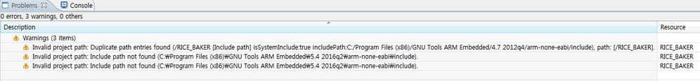

2016-12-06 9:44 PM
Dear Sir Clive1,
I have build the actual coo-cox project without any alteration,
For this time its shows,
GCC HOME: C:\Program Files (x86)\GNU Tools ARM Embedded\4.7 2012q4\bin
compile: [mkdir] Skipping C:\STM32_toolchain\Workspace\cooker_2016\rice_baker\Debug\bin because it already exists. [mkdir] Skipping C:\STM32_toolchain\Workspace\cooker_2016\rice_baker\Debug\obj because it already exists. [cc] 31 total files to be compiled. [cc] arm-none-eabi-gcc -mcpu=cortex-m3 -mthumb -Wall -ffunction-sections -g -O3 -c -DSTM32F070xB ''-IC:\STM32_toolchain\Workspace\cooker_2016\key driver'' -IC:\STM32_toolchain\Workspace\cooker_2016\common\Drivers -IC:\STM32_toolchain\Workspace\cooker_2016\common\Drivers\STM32F0xx_HAL_Driver\Inc ''-IC:\STM32_toolchain\Workspace\cooker_2016\key driver\key'' -IC:\STM32_toolchain\Workspace\cooker_2016\states -IC:\STM32_toolchain\Workspace\cooker_2016\command -IC:\STM32_toolchain\Workspace\cooker_2016 -IC:\STM32_toolchain\Workspace\cooker_2016\common\Drivers\CMSIS\Device\ST -IC:\STM32_toolchain\Workspace\cooker_2016\common\Inc -IC:\STM32_toolchain\Workspace -IC:\STM32_toolchain\Workspace\cooker_2016\io_utils -IC:\STM32_toolchain\Workspace\cooker_2016\common\Drivers\CMSIS\Device\ST\STM32F0xx\Include -IC:\STM32_toolchain\Workspace\cooker_2016\common -IC:\STM32_toolchain\Workspace\cooker_2016\common\Drivers\CMSIS\Include -IC:\STM32_toolchain\Workspace\cooker_2016\common\Drivers\CMSIS -IC:\STM32_toolchain\Workspace\cooker_2016\common\Drivers\STM32F0xx_HAL_Driver -IC:\STM32_toolchain\Workspace\cooker_2016\flash\app -IC:\STM32_toolchain\Workspace\cooker_2016\common\Drivers\CMSIS\Device\ST\STM32F0xx ''-Ic:\program files (x86)\gnu tools arm embedded\5.4 2016q2\arm-none-eabi\include'' -IC:\STM32_toolchain\Workspace\cooker_2016\common\Drivers\STM32F0xx_HAL_Driver\Inc\Legacy -IC:\STM32_toolchain\Workspace\cooker_2016\flash C:\STM32_toolchain\Workspace\cooker_2016\common\Drivers\STM32F0xx_HAL_Driver\Src\stm32f0xx_hal_pwr.c C:\STM32_toolchain\Workspace\cooker_2016\common\Src\spi.c '''C:\STM32_toolchain\Workspace\cooker_2016\key driver\key\hs_key_handle.c''' C:\STM32_toolchain\Workspace\cooker_2016\common\Src\i2c.c C:\STM32_toolchain\Workspace\cooker_2016\common\Drivers\STM32F0xx_HAL_Driver\Src\stm32f0xx_hal_rcc.c C:\STM32_toolchain\Workspace\cooker_2016\common\Src\tim.c C:\STM32_toolchain\Workspace\cooker_2016\common\Drivers\STM32F0xx_HAL_Driver\Src\stm32f0xx_hal.c C:\STM32_toolchain\Workspace\cooker_2016\common\Drivers\STM32F0xx_HAL_Driver\Src\stm32f0xx_hal_spi_ex.c C:\STM32_toolchain\Workspace\cooker_2016\common\Src\main.c C:\STM32_toolchain\Workspace\cooker_2016\io_utils\io_util.c C:\STM32_toolchain\Workspace\cooker_2016\common\Drivers\STM32F0xx_HAL_Driver\Src\stm32f0xx_hal_rcc_ex.c C:\STM32_toolchain\Workspace\cooker_2016\common\Src\gpio.c C:\STM32_toolchain\Workspace\cooker_2016\common\Drivers\STM32F0xx_HAL_Driver\Src\stm32f0xx_hal_flash_ex.c C:\STM32_toolchain\Workspace\cooker_2016\common\Drivers\STM32F0xx_HAL_Driver\Src\stm32f0xx_hal_dma.c C:\STM32_toolchain\Workspace\Source_bak\common\Drivers\CMSIS\Device\ST\STM32F0xx\Source\Templates\gcc\startup_stm32f070xb.s C:\STM32_toolchain\Workspace\cooker_2016\common\Drivers\STM32F0xx_HAL_Driver\Src\stm32f0xx_hal_cortex.c C:\STM32_toolchain\Workspace\cooker_2016\common\Drivers\STM32F0xx_HAL_Driver\Src\stm32f0xx_hal_spi.c C:\STM32_toolchain\Workspace\cooker_2016\flash\app\flash_conf.c C:\STM32_toolchain\Workspace\cooker_2016\common\Drivers\STM32F0xx_HAL_Driver\Src\stm32f0xx_hal_i2c.c C:\STM32_toolchain\Workspace\cooker_2016\states\global.c C:\STM32_toolchain\Workspace\cooker_2016\common\Src\stm32f0xx_hal_msp.c C:\STM32_toolchain\Workspace\cooker_2016\common\Drivers\STM32F0xx_HAL_Driver\Src\stm32f0xx_hal_flash.c C:\STM32_toolchain\Workspace\cooker_2016\common\Drivers\STM32F0xx_HAL_Driver\Src\stm32f0xx_hal_i2c_ex.c C:\STM32_toolchain\Workspace\cooker_2016\common\Drivers\CMSIS\Device\ST\STM32F0xx\Source\Templates\system_stm32f0xx.c C:\STM32_toolchain\Workspace\cooker_2016\common\Src\stm32f0xx_it.c C:\STM32_toolchain\Workspace\cooker_2016\common\Drivers\STM32F0xx_HAL_Driver\Src\stm32f0xx_hal_pwr_ex.c C:\STM32_toolchain\Workspace\cooker_2016\common\Drivers\STM32F0xx_HAL_Driver\Src\stm32f0xx_hal_tim_ex.c C:\STM32_toolchain\Workspace\cooker_2016\states\main_state.c C:\STM32_toolchain\Workspace\cooker_2016\common\Drivers\STM32F0xx_HAL_Driver\Src\stm32f0xx_hal_tim.c C:\STM32_toolchain\Workspace\cooker_2016\states\sevenseg_state.c C:\STM32_toolchain\Workspace\cooker_2016\common\Drivers\STM32F0xx_HAL_Driver\Src\stm32f0xx_hal_gpio.c [cc] C:\STM32_toolchain\Workspace\cooker_2016\states\sevenseg_state.c: In function 'seg_seq_control': [cc] C:\STM32_toolchain\Workspace\cooker_2016\states\sevenseg_state.c:121:20: warning: 'pre_gpio_group' may be used uninitialized in this function [-Wmaybe-uninitialized] [cc] C:\STM32_toolchain\Workspace\cooker_2016\states\sevenseg_state.c:134:22: warning: 'gpio_group' may be used uninitialized in this function [-Wmaybe-uninitialized] [cc] C:\STM32_toolchain\Workspace\cooker_2016\states\sevenseg_state.c:121:20: warning: 'pre_gpio_pin' may be used uninitialized in this function [-Wmaybe-uninitialized] [cc] C:\STM32_toolchain\Workspace\cooker_2016\states\sevenseg_state.c:134:22: warning: 'gpio_pin' may be used uninitialized in this function [-Wmaybe-uninitialized] [cc] Starting link [cc] arm-none-eabi-gcc -mcpu=cortex-m3 -mthumb -g -Wl,-Map=RICE_BAKER.map -O3 -Wl,--gc-sections -LC:\CooCox\CoIDE\configuration\ProgramData\RICE_BAKER -Wl,-TC:\CooCox\CoIDE\configuration\ProgramData\RICE_BAKER/arm-gcc-link.ld -g -o RICE_BAKER.elf ..\obj\stm32f0xx_hal_pwr.o ..\obj\spi.o ..\obj\hs_key_handle.o ..\obj\i2c.o ..\obj\stm32f0xx_hal_rcc.o ..\obj\tim.o ..\obj\stm32f0xx_hal.o ..\obj\stm32f0xx_hal_spi_ex.o ..\obj\main.o ..\obj\io_util.o ..\obj\stm32f0xx_hal_rcc_ex.o ..\obj\gpio.o ..\obj\stm32f0xx_hal_flash_ex.o ..\obj\stm32f0xx_hal_dma.o ..\obj\startup_stm32f070xb.o ..\obj\stm32f0xx_hal_cortex.o ..\obj\stm32f0xx_hal_spi.o ..\obj\flash_conf.o ..\obj\stm32f0xx_hal_i2c.o ..\obj\global.o ..\obj\stm32f0xx_hal_msp.o ..\obj\stm32f0xx_hal_flash.o ..\obj\stm32f0xx_hal_i2c_ex.o ..\obj\system_stm32f0xx.o ..\obj\stm32f0xx_it.o ..\obj\stm32f0xx_hal_pwr_ex.o ..\obj\stm32f0xx_hal_tim_ex.o ..\obj\main_state.o ..\obj\stm32f0xx_hal_tim.o ..\obj\sevenseg_state.o ..\obj\stm32f0xx_hal_gpio.o [cc] ..\obj\startup_stm32f070xb.o: In function `LoopForever': [cc] C:\STM32_toolchain\Workspace\Source_bak\common\Drivers\CMSIS\Device\ST\STM32F0xx\Source\Templates\gcc/startup_stm32f070xb.s:67: undefined reference to `_estack' [cc] ..\obj\startup_stm32f070xb.o:(.isr_vector+0x0): undefined reference to `_estack' [cc] collect2.exe: error: ld returned 1 exit statusBUILD FAILED
Total time: 7 secondsKindly take a look whole console and suggest me what should I do.

2016-12-08 12:10 AM
It does use the arm-none-eabi-gcc, but it allows you to use any toolchain version you want, even to install multiple versions at the same time and chose one per project.
And the project creation wizard does support STM32F0 directly.
BTW, in your case the compile errors might be caused by the wrong selection of the device, F0 is a Cortex-M0 not a Cortex-M3.
As for the benefits of using Eclipse, the short answer is 'the indexer'. There is no other IDE with a better knowledge of your program than Eclipse, and as such it helps you view your programs better, it greys unused sequences of code, it shows the function definitions on mouse over, etc.
