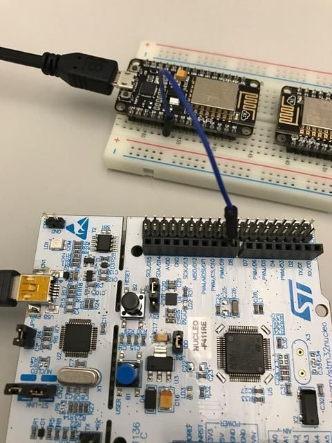

No Problem. Thanks. Here it is. I don't have any common ground and you can see that I can plug in the USB battery separately through the mini-USB to the Nucleo board or micro-USB to the ESP8266 Nodemcu. I need one TX output from D8 of Nucleo to send the data to the RX02 (D7) of the ESP8266 Nodemcu. And I can add another wire to connect the GND to become common GND?!
2017-03-01 11:59 PM
Ok so now it makes more sense. You cannot omit to link the 2 grounds together, as it acts as a reference for the Tx signal for both boards. When you used the PC as power source for both boards, their grounds was more or less the same (depending on the current consumption and the USB cable resistance which is negligible here). Therefore the Tx signal was correctly referenced for both.
Now, I'm quite confident that if you add a wire to link the 2 grounds together so that they are the same it will work.

Thanks a lot, Kraal!
It works after I connect the GND together and I can even use one USB battery to drive both now
as I use pin 12 of CN7 to give the 3.3V to the Wifi module.
