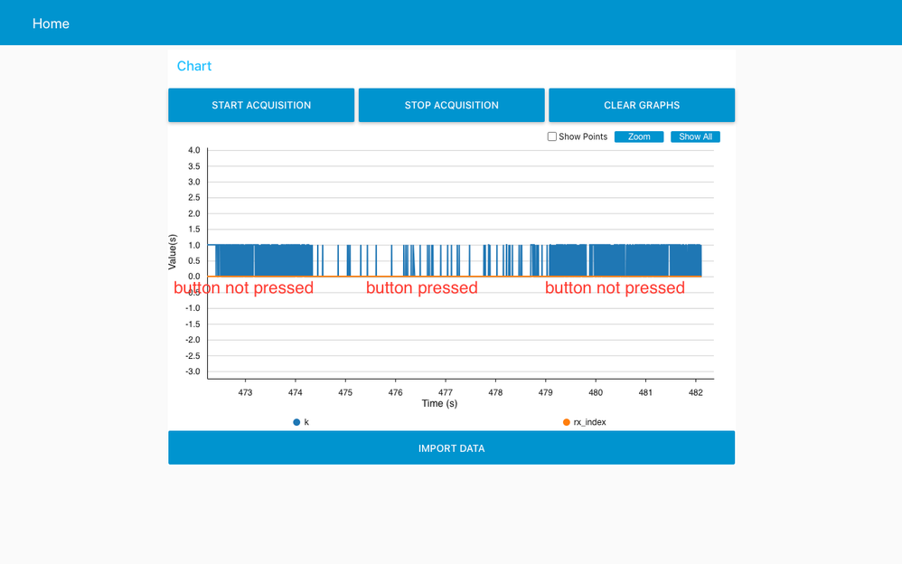

}and, the value of 'k' over time is:
the value of 'k' over time("button" is the button of the rf433 transmitter)
as it can be seen from the picture, interrupt is triggered even when no signal is received.

I don't have access to oscilloscope or logic analyzer. However, I was able to observe the value of 'k' (which becomes 1 by interrupt ) by the stm32cubeMonitor (the attached picture).

I have the assumption that the pin should only oscillate while receiving 433mhz signal.
2021-09-17 5:12 AM
Sure seems like the pin is toggling even when you don't expect it, doesn't it? What would be a different explanation?
Disconnect the pin and tie it to ground. I'll bet the variable doesn't change anymore.
