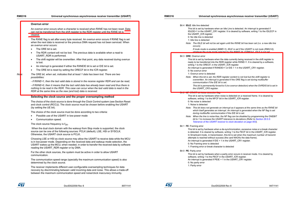

2023-01-02 5:16 AM
Watch for overrun condition. It can block reception.
2023-01-02 5:46 AM
Thanks.
How do I check that?

2023-01-02 10:56 AM
Overrun detection reports interrupt latency failure. Suggest to use LL low layer for uart communication to reduce WCET.

@DBERG.1 The problem is not overrun but how you're using HAL_UART_Receive_IT incorrectly
For UART2, I see that you don't even look at the HAL return status. Once HAL_UART_Receive_IT does not return HAL_OK, then that UART port will no longer receive an interrupt. HAL returns HAL_OK or HAL_BUSY where the latter is the most common when UART stops receiving data. That UART port is now dead in the water. There is HAL_ERROR but that is a very rare case.
I assume in the other reading functions you're calling HAL_UART_Receive_IT but also not looking at HAL return status?
What you need to do is set an error flag so you can then later in a polling routine, try to enable interrupts again for that UART port when HAL is not busy.

Besides of reducing overhead as @Johi mentioned, HAL_UART_Receive_IT(..., ..., 1) should be avoided. It disables the RX interrupt after receiving the requested number of bytes (1). This opens a time window until the interrupt is enabled again, and RX event can be lost or overrun can occur.
HAL_UART_Receive_IT( ... , x > 1) is only slightly better. If a received byte is lost because of line noise or framing errors, the requested number of bytes may be not received in expected time. It is unlikely but things happen.
