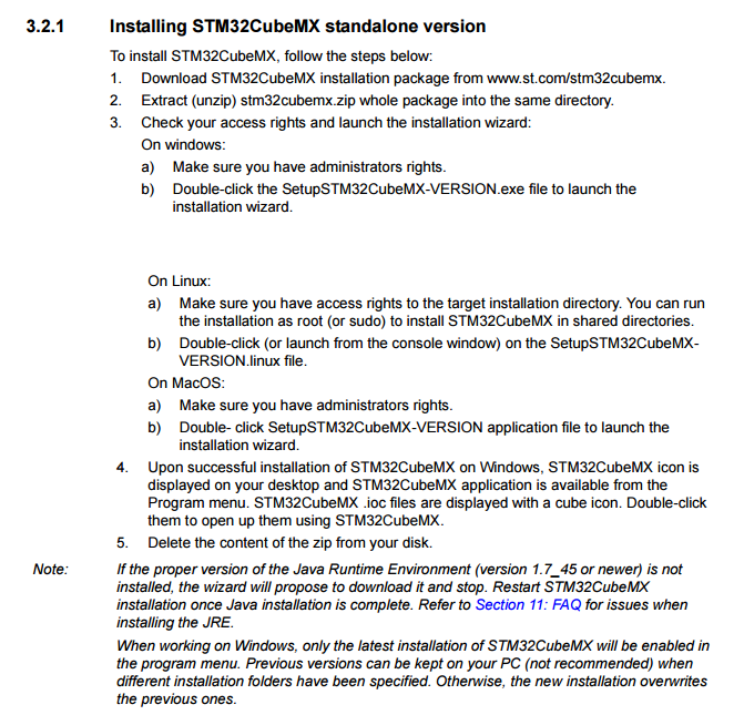

Are you following the instructions in this
manual to install STM32CubeMX in command-line mode and install the software requirements as Java Development Kit 1.7.0_45 ?You should make sure that you have administrator rights.
