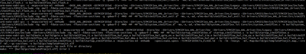

I am working on the STM32 project and using the makfile to compile and generate respective hex and bin files.
I have configured all the setups using adding path in windows10 os environment variables for makefile and gnu gcc compiler.
It compiles and gives the error -
arm-none-eabi-gcc -x assembler-with-cpp -c -mcpu=cortex-m3 -mthumb -DUSE_HAL_DRIVER -DSTM32F103xE -ICore/Inc -IDrivers/STM32F1xx_HAL_Driver/Inc -IDrivers/STM32F1xx_HAL_Driver/Inc/Legacy -IDrivers/CMSIS/Device/ST/STM32F1xx/Include -IDrivers/CMSIS/Include -Og -Wall -fdata-sections -ffunction-sections -g -gdwarf-2 -MMD -MP -MF"build/startup_stm32f103xe.d" startup_stm32f103xe.s -o build/startup_stm32f103xe.o
arm-none-eabi-gcc build/main.o build/gpio.o build/stm32f1xx_it.o build/stm32f1xx_hal_msp.o build/stm32f1xx_hal_gpio_ex.o build/stm32f1xx_hal_tim.o build/stm32f1xx_hal_tim_ex.o build/stm32f1xx_hal.o build/stm32f1xx_hal_rcc.o build/stm32f1xx_hal_rcc_ex.o build/stm32f1xx_hal_gpio.o build/stm32f1xx_hal_dma.o build/stm32f1xx_hal_cortex.o build/stm32f1xx_hal_pwr.o build/stm32f1xx_hal_flash.o build/stm32f1xx_hal_flash_ex.o build/stm32f1xx_hal_exti.o build/system_stm32f1xx.o build/startup_stm32f103xe.o -mcpu=cortex-m3 -mthumb -specs=nano.specs -TSTM32F103VCTx_FLASH.ld -lc -lm -lnosys -Wl,-Map=build/gccTemplateProejct.map,--cref -Wl,--gc-sections -o build/gccTemplateProejct.elf
arm-none-eabi-gcc: error: nano.specs: No such file or directory
make: *** [build/gccTemplateProejct.elf] Error 1
I request all to please share the solution for the same.
Thanks & Regards
