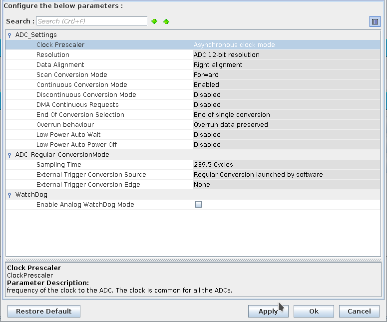

2018-01-20 12:35 AM
Finally this is my CubeMX setup
This is my callback
unsigned int ADCValues[5];
unsigned int ADCIndex= 0;void HAL_ADC_ConvCpltCallback(ADC_HandleTypeDef *hadc) {
if (__HAL_ADC_GET_FLAG(hadc, ADC_FLAG_EOC)) { ADCValues[ADCIndex]= HAL_ADC_GetValue(hadc); ADCIndex++; } if (__HAL_ADC_GET_FLAG(hadc, ADC_FLAG_EOS)) ADCIndex= 0;}And outside che callback I check the ADCValues[2] and ADCValues[3] where I should have the Temperature and Vdd values.
Is this the right approach? The Temperature value now seems to be ok.2018-01-20 4:06 AM

Reading the values outside the sampling loop I believe is a better approach.
The internal channels are high impedance sources, so T. J.'s example using 1.5 cycles will produce inaccurate results with any sampling method.
The root difficulty that ADC programmers have to overcome is ST's design of using one data register per ADC. The best software approach is to use DMA to save a sampling sequence to memory, then process the results when the DMA counter gets to zero. ST's ADC Sequencer example is a highly convoluted, inefficient way to do a simple task, and I suspect it leads beginner's astray.
