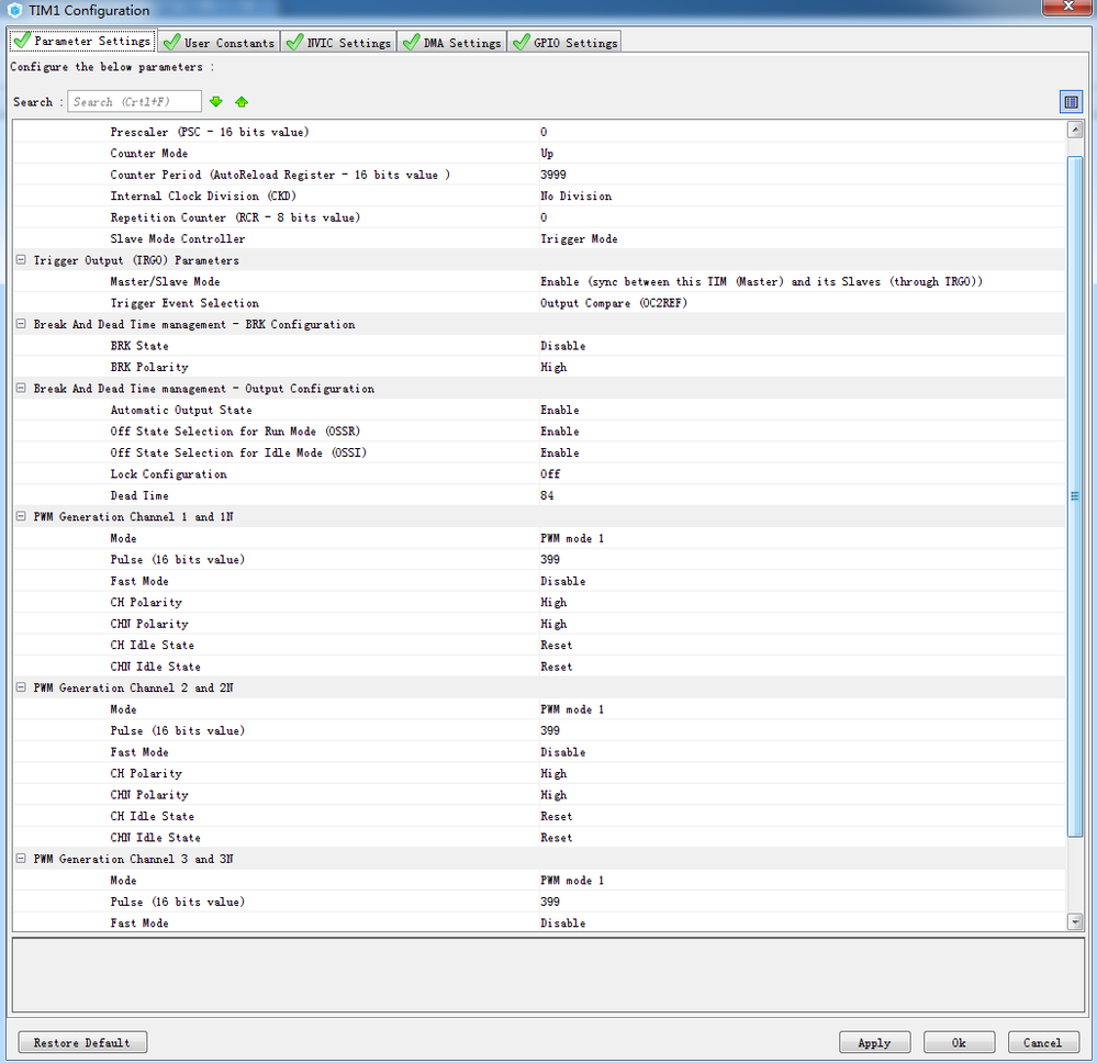

2017-08-09 6:45 PM
Thanks Vangelis. I want to deactivate the whole CH3(both CH3 and CH3N) on the fly(when commutation occurred). I would like to post more detail configuration with cubemx.

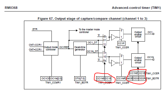

I would like to share my progress. I use the mode LL_TIM_OCMODE_INACTIVE instead of the mode LL_TIM_OCMODE_FORCED_INACTIVE and tried several combination of enable or disable channels. Now it works. But I am still confused with the following figure described in the reference manual
I can't catch up the logic to match Figure 67. Additionally, when I enable preload, the status change will occur before the COM interrupt happened for about 1.6ms. I use stm32f401, the main clock is 84MHz.

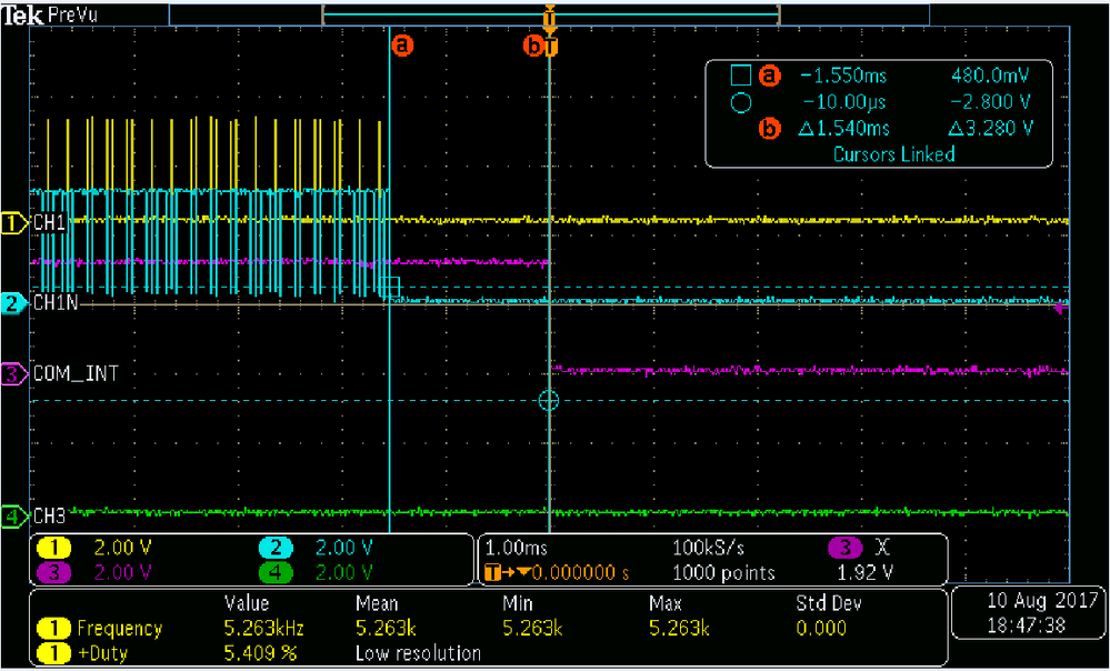

In conclusion, after I can make the 3rd channel deactive on both side, the motor can run. But it seems it doesn't provide enough power though duty cycle is 10%. It will stopped sometime. I am not sure why, I guess the commutation time is not exactly correct. And I wonder to know why status change occurred before COM interrupt(Hall sensor changed)?
2017-08-10 4:01 AM
Channel 3 : COM_INT indicates COM interrupt service routine called
Channel 1: CH1 indicates PHASE A high side control signal
Channel 2: CH1N indicates PHASE A low side control signal
It shows that the actual commutation signals are generated a little bit before Hall Sensor Event triggered for 1.54ms. Why?

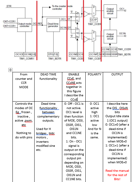

2017-08-10 5:12 AM
Hi Jason!
Take a look at theese circled bits. to understand their meaning. OIS1N, OIS1, OIS2N, OIS2, OIS3N, OIS3 bits are omitted from figure (for some unknown reason)
If something of theese fits to your concept, use it.
Last resort is to change the GPIO MODER relevant to your GPIO , register
2017-08-10 7:03 AM
Hello again!!
I'm glad you realized you should use low(er)-level functions or/and register level programming
The ''description'' here is as starter to further study the registers , flags and bits.
For the last question, you probable have some delay to the signal to LA.
If you use interrupts to make a GPIO as output , this delay is posible to occur.(but not sure ofcourse)
2017-08-10 9:28 PM
Hi Vangelis,
Appreciate for your guidance of Fig 67. It makes more clear than the reference manual.
For the last question, I don't agree GPIO toggling delay would be 1ms or more. After I changed the commutation table, it works better. As I would like to exactly control the commutation time. On the other hand, the commutation delay set to the master timer(TIM4) doesn't work. I am working on it.
