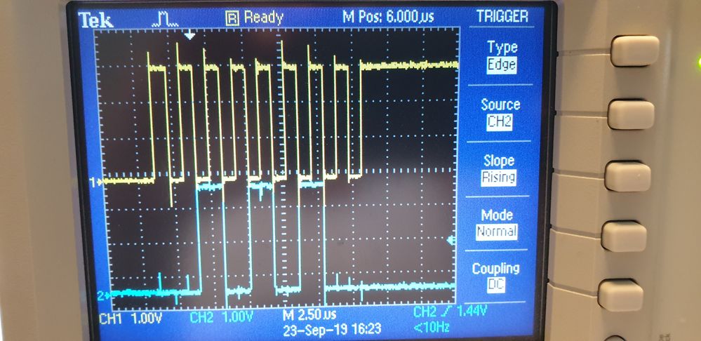

Following is from my mbed program which is able to send command to adc and read back the reg. (sending 0x54=0b01010100 cmd)
Yellow is SPI clk, blue is MOSI

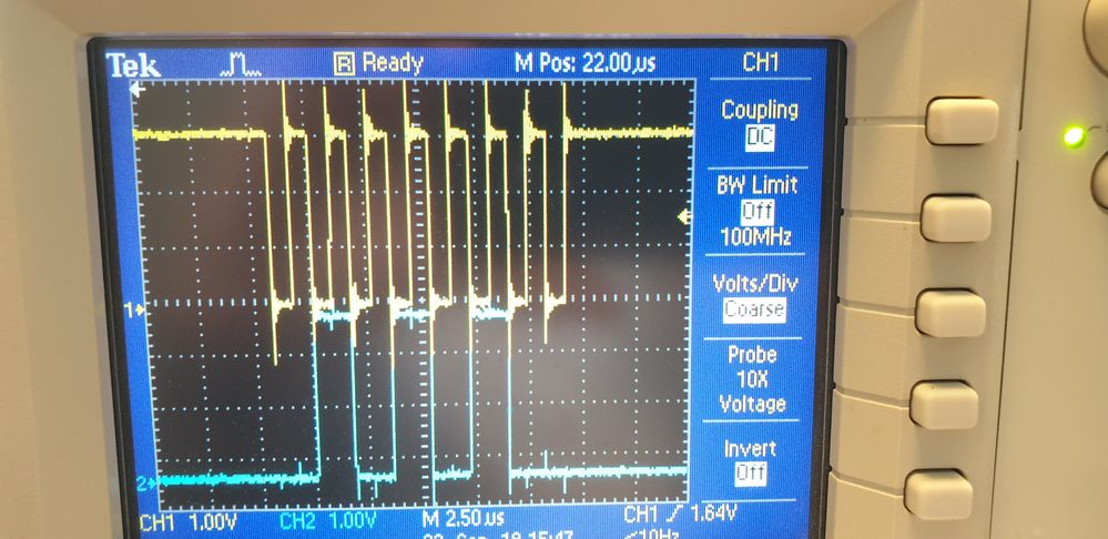

Pic below is from my own lowlevel SPI implementation
The master clk in second pic is not idling high. Can this explain why I am unable to talk to the slave using my SPI config?
2019-09-23 7:51 AM
So basically in the second case I was sending the SPI msg from master immediately after enabling SPI. After adding artificial delay , now both mbed and my implementation CLK/MOSI signals look the same.
Still no answer from the slave spi (works with mbed program). Now I am at a total loss. any one got any ideas?
